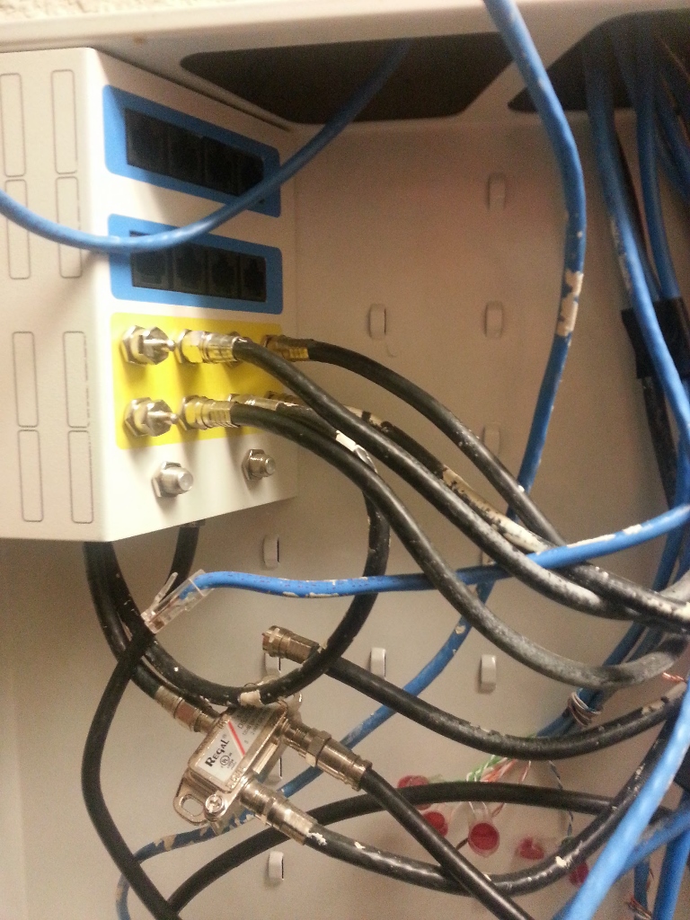

Antenna Coax internal network panel
Nothing is labeled in my internal network panel and I'm trying to connect my antenna coax to the cable feed that runs throughout my house. I've attached a picture. Any ideas how/where I should plug in the antenna cable?

It looks like you have a QND88P http://www.security.honeywell.com/hs...nel/50028.html
http://www.smarthome.com/8680D88P/Qu...-Jacks-/p.aspx
The coax cables plugged into the yellow ports should go to rooms with TV jacks. Any unused jacks should have a terminator installed (either in the room a cable runs to or at the distribution module.)
On the back of the module there should be an input to the 8 way splitter, that is where your antenna coax should attach. Are you using a preamp, or is an amplifier built into your antenna? If so, the power inserter needs to go between the distribution module and the coax from the attic.
Do you or did you have cable? With the 8-way distribution module, the 2 way splitter is surprising to see. Do you currently have cable internet?
How many TV’s do you have? An 8-way splitter may be overkill if you don’t have 5 or more TV’s.
@stvcmty: thanks for the reply. No amplifier that I know of. I did have cable at one time and cable internet. I am planning to go back to cable internet since it is faster and I'm streaming alot. I have 2 TV's now and may add a third down the road.

In my opinion in general, a passive 8 way splitter being used for 2 or 3 TV’s adds excessive loss to a system (this could be true or not depending on what is feeding the splitter.)
If you have 2 TV’s now, and possibly will add a 3rd one in the future, I would get a 4 way splitter. The lead from the antenna in the attic would go to the “in” on the 4 way splitter. The coax’s to the rooms with TV’s would go to the outs on the splitter. The unused outputs on the splitters should be terminated with 75ohm terminators. I suggeste a 4 way splitter because you may add a 3rd TV in the future, and most 3 way splitters are a 2 way split followed by another 2 way split, so one port has more signal than the others, where a 4 way splitter will have 4 ports with the same signal level on all of them. Unless you need one port with more signal than the others, the 4 port is nice because it gives you room to add a 4th TV later.
Cable service for cable internet must be separate from OTA HDTV. The cable modem should be attached directly to where the cable company’s signal comes in. There should be no signal connection between cable and antenna.
