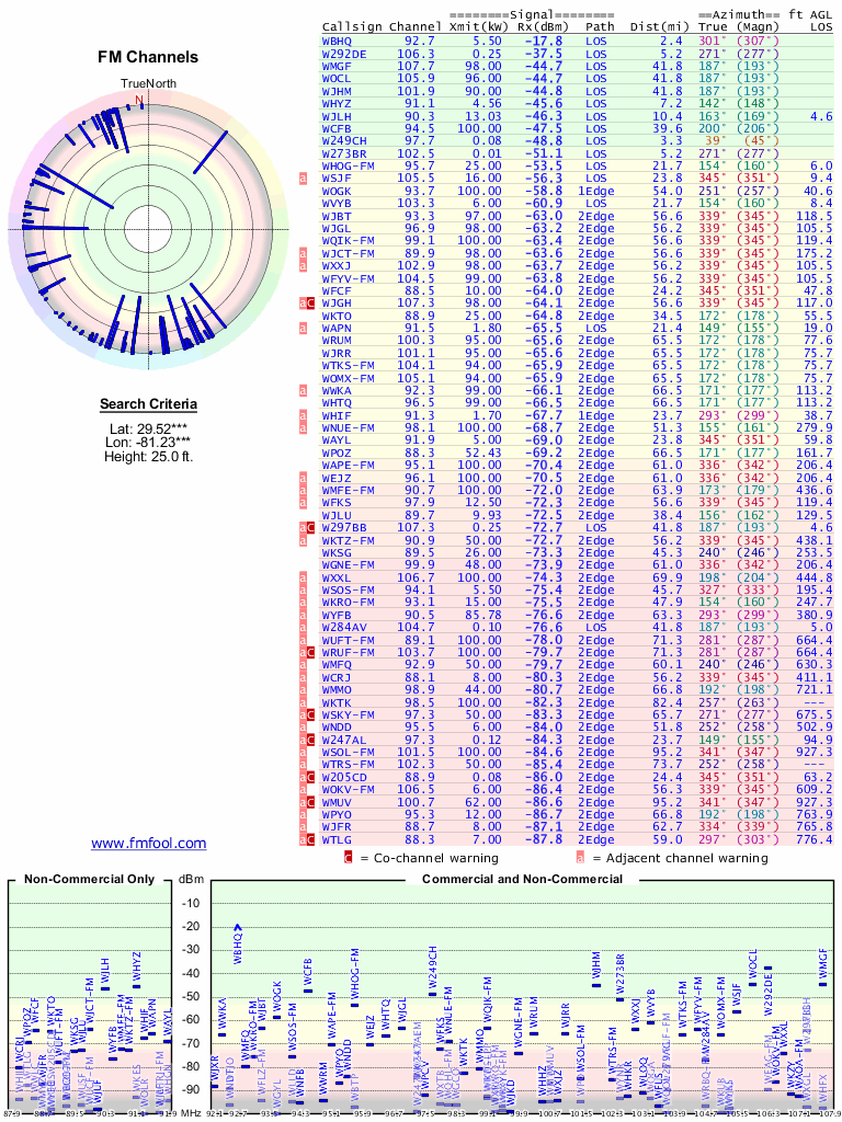

Based on your ZIP code, there are several local FM stations. Use of an FM trap ahead of any amplifier would be a good idea.

Thank you very much, GroundUrMast for your responce. I think you miss read when i mentioned that at night i get all of the 74 channels is not an antenna issue or am i mistaken I get perfect quality and perfect reception so i don't think is an antenna issue, another thing I don't think i need an FM trap what would that do for me? As I mentioned is only in the day time that i loose most of the channels. I was thinking maybe lowering my antenna a little would help? I don't know?

Based on the signal analysis for your location, my theory is that you are receiving a marginal quality signal at night. As the sun rises television signals experience more interference. Digital TV will look virtually perfect until the signal quality drops to the point were data errors occur. At that point the picture may pixel-ate, come and go or just quit completely.
FM stations near you can also be a source of interference to weak DTV signals.
If you are able to increase the height of your antenna, you can expect to get it little more signal strength... that might be enough to improve some of the signals lost during the day. I would expect that lowering the antenna would most likely make things worse.
