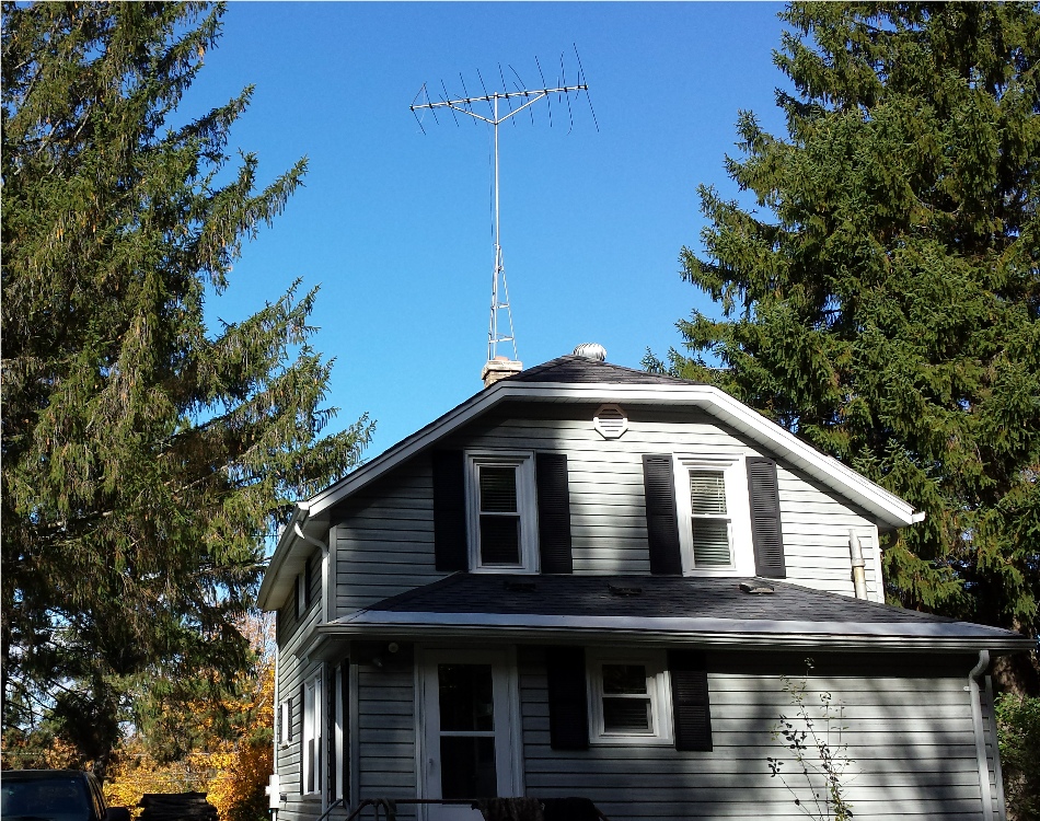

There is a very old antenna facing 320 degrees (via compass).
We receive channels
Channel, Gain
8.1, 21%
8.2, 24%
8.3, 26%
8.4, 21%
10.1, 21%
10.2, 23%
36.1, 10%
36.2, 11%
36.3, 13%
All the channels may brake up if it is windy. As the attached photo shows there are 80'+ pine trees blocking about 280-330 degrees. Woods and hill to south. More large pine trees to east.
The house isn’t used often so I am looking for options to receive the 21.1(Fox) and 6.1 (NBC) without spending a lot of money. Only one TV is used.
We do not receive W32CV at all.
What is the maximum gain you can expect to receive?

There is a very old antenna facing 320 degrees (via compass). There is not a rotor.
We receive channels:
8.1, 21%
8.2, 24%
8.3, 26%
8.4, 21%
10.1, 21%
10.2, 23%
36.1, 10%
36.2, 11%
36.3, 13%
The house isn’t used often so I am looking for options to receive the 21.1(Fox) and 6.1 (NBC) if possible and improve the current reception without spending a lot.
The attached photo shows the 80' plus trees blocking 280-330 degrees. Also woods and a hill are to the south and anything west is has large pin trees. The property is on high ground clockwise 270-90 degrees. South has the hill but we do receive 36.
Any suggestion are appreciated.

Those are some difficult conditions with 3 out of your 4 strongest signals being in different directions. Your current antenna is a warrior though. Been airborne awhile judging by the conditions of the elements.
Further, your current antenna appears to be VHF only. Which explains your challenge in receiving real channel 32 on UHF. A set up that'd use your existing mounting and would provide a test would be to purchase a Winegard HD8200U coupled to a RCA TVPRAMP1R pre-amp and aim it at 289 magnetic. You may get lucky and see RF 17 and 19, at very least it'll provide you knowledge that you have to go to the extreme level to pick up those signals which I elaborate on in the next paragraph.
Now the bad news and I hate to be the bearer of, but your signals on real channels 17 and 19 at 289 magnetic are the stuff of extremes. It is a positive you receive real channel 8. However, the foliage path blockage at 289 is something you have to get above especially for UHF signals, then there is no guarantee you will get RF 17 and 19. In certain cases single digit negative db signal strengths can be received, but getting into double negative digits is, as I mentioned, is the stuff of extremes. You can try, for example two Antennas Direct 91xgs co-phased for UHF coverage then a Antennacraft Y10713 for VHF coverage mounted three to four feet below the 91xgs atop a 100' tower to overcome immediate path blockages. However, that is a set up that'll run you a hefty bill of a several thousand dollars out the gate and that still may not reliably get the channels on 17 and 19. This is the kind of set up it'll take to pull in RF 17 and 19, presuming it's even possible.
Your situation actually reminds of me Richmond, Indiana. Many 50, 75 and even 100' towers snuggled right up against houses in efforts to receive Indianapolis TV, which in most of that city the Indy signals are down at low single digit db strengths above zero. A better situation than you have with the Duluth-Superior signals.
Why don't you for research purposes rerun your plot for your address at 100', 250' and 500' then share that with us. That will give some idea as to the level of edges and at what height the signals improve, if at all.

Given the extreme distance between you and the transmitting antennas, some realistic expectations need to be set. Even with the following system you may not achieve fully reliable reception.
The largest antennas are needed if your are going to have a chance at reliable reception. You'll also need to be able to mount clear of the tree(s).
I would try an Antennas Direct DB8e equipped with their PA-18 preamplifier. It's goal would be real CH-17 & 19.
An Antennacraft Y10713 also equipped with a PA-18 preamplifier would be my choice for attempting reception of real CH-8 & 10.
Presuming you found acceptable reception with each antenna, you would then be able to combine the outputs of the separately amplified down-leads using a standard UHF/VHF signal combiner (UVSJ).

The trees will always be a problem (breakups when the wind blows) unless you can clear them one way or another.
Otherwise, GUM's suggestions are about as good as it is going to get. You might want to add a rotor for the UHF (only) antenna.

Aiming under trees, if that affords a clearer path towards the horizon, can often improve reception by avoiding the detrimental effects that foliage has on weak signals.
However, your forecasted signals are very weak. You'll have to do as much right as possible in order to improve reception.

No matter what , a Big antenna is required for reception , to go after reliable reception of NBC , and to receive as many channels as possible.
As a Test of reception , remove the old beat up antenna and in it's place install a Winegard HD7698P antenna.
Replace All outside coax with New RG-6 coax that has the Compression type connectors on the ends of the coax , not the old crimp type connectors.
Replace All outside coax system connections and couplers.
Install a Winegard LNA-200 'Boost' XT antenna system amplifier.
_____________________
Test reception in 2 directions.
About 138 degree magnetic compass direction.
Use a Real and Actual magnetic compass to aim antenna.

New goal cleanup 8 10 and 36, also pickup the FOX analog rebroadcast of 32.
#1? The current antenna is not good for UHF (14-69). It also maybe 40 years old.
#2? Should I add a rotor?
#3? Why does the 8' antenna ht provide better values.
#4? Keep current antenna and add UHF specific?
You need to avoid the trees, whether by going over, around or putting them in the fireplace. If you can't do that, this is a futile effort.
You've seen what the existing antenna does with 8 & 10 already, which leads to questions #1 & #4 - It's clear from the photo that the antenna is a VHF only design, it never was intended to receive UHF frequencies. It's bent to the point of needing to be replaced. The Y10713 is the best option in a cut for band H-VHF antenna that covers those two channels.
A DB8e is not overkill when aiming for WLEF to the south. It may produce a viewable signal from CH-32 when aimed at CH-36.
#2 - A rotator would be helpful when trying to fine tune exact aim point. Given the intention of serving only one TV, It may prove helpful if you want to optimize the reception of CH-32 & CH-36.
#3 - The Longley-Rice model used by TV Fool is known to exhibit this type of behavior. Sometimes the estimate produced is quite accurate, though in other cases, the axiom 'your mileage may vary' is quite apropos.
I talked with my uncle last night and he said the antenna could easily be over 50 years old.
