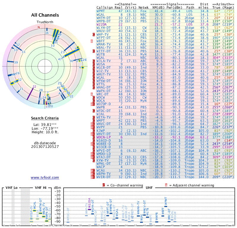

Help with selecting an antenna
Can someone please assist me in selecting the best type of antenna to receive as many channels as possible (including WBAL). Here is my radar information: http://www.tvfool.com/?option=com_wr...46ae974e619f0c

Above the roof in such a manner that reception is not , obstructed , impeded , blocked , by the roof and building in the directions of , East , North East.
Install a Channel Master CM4228HD antenna aimed at about 62 degree magnetic compass direction.
Here is how to aim antennas , www.kyes.com/antenna/pointing/pointing.html
Use a Real and Actual magnetic compass to aim antenna.
Install a Channel Master CM7778 preamp.
For 1Tv connected use No splitter.
For 2 Tv's connected use a Holland Electronics , HFS-2D , 2 way splitter.
For 3 Tv's connected use a Holland Electronics , HFS-3D , 3 way splitter.

Can also Test reception of the Broadcast Tv stations/channels to the , South East , South , South West.
Aim the CM4228HD antenna about 180 degree magnetic compass direction.
Scan for channels.
