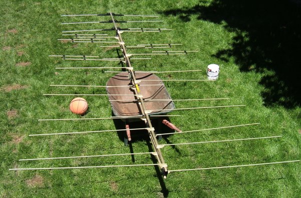

Absolutely. I had one of the best VHF-FM antenna years ago & it didn't really work any better than the FM6.
I actually had the even larger 1110(16 feet long), but could't find a pic.

I bought the 6055 to mess around with. I can't return the FM6 since I threw the box away. I found it strange that I got all the TV channels that I get with the HD Stacker since the FM6 is only for low VHF. The signal strength was just as strong too.
