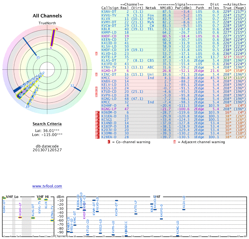

I live almost directly under Black Mountain, where there are several antennas for stations that I can pick up just fine. However, the CBS and ABC affiliates (KLAS and KTNV) are located a couple miles further back on another mountain. It says there is double edge diffraction for these signals. I don't know how/where to position the antenna to pick up any signal at all. My antenna is the Clearstream Micron XG with reflector and amplifier (up to 20dB), and a peak gain of 8.4dBi. I'm wondering if using the amplifier will help, but I'm not even picking up any signal to amplify. I can't put the antenna on the roof because of my condo association regulations. I guess I'm just confused as to how to deal with the double edge diffraction. Any help would be most appreciated.
http://www.tvfool.com/?option=com_wr...46ae9cc30ac936

You can't use an amplified antenna at your location. Consider a Terk HDTVI antenna.

The Micron isn't likely to help with those terrain-blocked VHF stations.
The smallest of our antennas that can be used indoors which includes reliable and predictable VHF support is our ClearStream 2V. You'll need to either fabricate or purchase a base for indoors usage, though. Please don't confuse the older ClearStream 2 with the newer ClearStream 2V.
As Tower Guy noted, you can NOT use any amplifier at your location. I'd suspect you'll likely need one or two FM filters while you're at it.
You may wish to call one of the affected station's engineering department. Ask them if your location near the base of the mountain is likely to receive their signals given the amount of shadowing likely present. I've found that almost all station engineers I've been in touch with are usually very willing to offer advice on how viewers can receive the signals from their equipment. They also usually know the limits of their coverage as far as where dead spots are known to exist.

The Terk HDTVi is a non amplified antenna, so it can't be overloaded by strong signals. It also has intentionally designed support for both UHF and VHF reception. Don't confuse this with the HDTVa which has a built-in amplifier.

Every window faces NE/N, away from the antennas, which are in plain sight from S/SW, except for CBS/ABC, which are back a bit and getting bounced off the mountain. I'm on the 1st floor of a 2 floor condo unit with stucco. I'm just not sure where to point/place the antenna to get any digital signal from CBS/ABC, because of double edge diffraction.

Stucko -> Wire <- aka chicken wire , is a Excelent reflector of tv signals.
The Tv transmissins bounce off the Wire and very little of the Tv signal gets to the antenna inside the building.
Placing a antenna in a window / patio door glass window , that is the ~direction~ of the transmitters will improve reception because glass and plexie glass is a very Small resistance to Tv transmission reception.
Here is the Federal Antenna Law that says , Yes you can install a antenna outside so as to have Reliable Broadcast Tv Reception.
http://www.fcc.gov/mb/facts/otard.html.
Install a ANT751 antenna on the outside of the building at a location that the building and or roof or both do not obstruct and block reception to the , South West / and North West.
Recommend install the ANT751 antenna UP High at a location that will provide the best unobstructed reception.

the ANT 751 may not get NBC on channel 2.

KSNV channel 2 is over the top strong signal strength at 87.5 NM(dB) and will be received.
