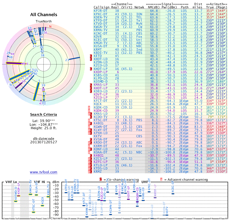

Thanks for your quick response attached is the radar plot and channel list.

Based on a 'Picture' of the tvfool report that is not a live and active tvfool report like the other question askers post because a live and active report is better for evaluation.
The Digital Broadcast Tv transmission and reception is strong signal strength at your location.
Above the Roof in such a manner that the roof and house are not impeding and blocking reception to the , South , South West , West , North West , North , East.
Install a ANT751 antenna aimed at about 213 degree magnetic compass direction.

The reception signal strength is strong at your location.
A antenna system amplifier Is Not required.
