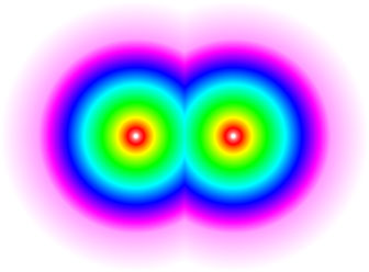

In an ideal world, one would expect that a DTS makes everything easier for the DTV receiver. When there are multiple transmitters nearby, you'd expect the receiver to simply use the strongest available signal and decode a beautiful DTV picture. If we look at a simple two transmitter example, where receiver performance is determined purely by the strongest signal available, we'd expect the coverage map to look something like this:

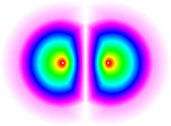

However, in reality this is not true because we are actually dealing with two signals here. While the receiver is trying to lock on to one of the signals, the other signal is acting as interference. The other signal might be farther away and not as strong, but it is interfering with the stronger signal nonetheless.
Depending on the location of the receiver, there will be places where one transmitter dominates over the other, or vice versa. In places where the signals approach equal power, the stronger signal might still be decodable, but the weaker signal behaves like a noise floor that limits the usable margin. In some areas, there will be a cross-over point where the signals are at equal power. Using our simple two transmitter example, the picture would look more like this:
But then you might ask yourself, "If these two transmitters are transmitting identical information, why would they interfere with each other?" Good question. The answer is that there is almost always a difference in the time of arrival for the signals. The receiver is almost always closer to one transmitter than the other.
The only points that are an equal distance from both transmitters are on a hyperbola that runs between them (straight down the middle in our symmetric example). Every other place on the map will have different arrival times for the two signals. Even though the signals are traveling at the speed of light, most places will have one signal arriving before the other. And even though the transmitters are sending identical information, the receiver will be seeing a digital signal and an identical delayed copy of the same signal superimposed on itself...
Since the 8-VSB (eight level VSB) signal contains mostly random data patterns, the resulting mix of constructive and destructive interference between the two patterns will make an almost random, undecipherable mess that the receiver cannot decode. As you get closer to one transmitter and further away from the other one, the noise contribution of the weaker signal diminishes.
Whenever two transmitters have overlapping coverage areas (imagine the coverage area of each transmitter by itself), there can be mutual interference problems. The severity of interference will depend on the relative signal strengths at each location. The worst interference will be in places where the signals are very close to equal power levels.
By the way, these delayed signal overlap issues are exactly the same as what you would see in a static multipath interference scenario. If there is static multipath in the environment (e.g., reflections off walls, buildings, trees, mountains, etc.), the receiver will see multiple copies of the same signal delayed by various amounts and at different power levels. In the days of analog television, these afterimages could be seen as "ghosts" in the picture.
