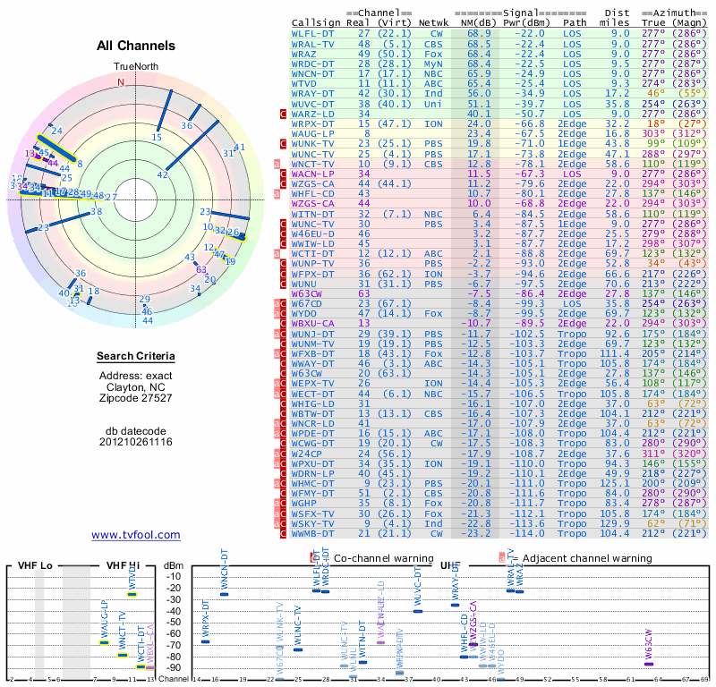

Was looking for some advice/assistance with my OTA antenna situation. Current set-up is an attic mounted Channel Master 4220HD Metrotenna with pre-amp. I tend to get multipath intereference from even the stations closest to my location as I live in a heavily wooded area. I primarily want to improve signal stability vs. quality.
TV Fool results are attached....would a larger antenna help my situation?
Any feedback would be appreciated.

teleview
Guest
Posts: n/a
Please post a Live And Active tvfool radar report , Not A Picture of a tvfool radar report.
Use the Exact address to make the tvfool radar report with the antenna height at 25 feet.

See attached live report here:
http://www.tvfool.com/?option=com_wr...cc495626b65d33

Old 15-Dec-2012, 2:56 PM   #5
teleview
Guest
Posts: n/a
Install a Winegard HD7696P antenna above the roof in such a manner that the roof and house are not blocking reception to the , west north west and north east.
Aim the HD7696P antenna at about 312 degree magnetic compass direction.
If WRPX-DT UHF channel 15 ION at 27 degree magnetic compass direction is not received and you will like to to receive , try adjusting the direction of the HD7696P antenna.
If still not received install the Channel Master antenna aimed at about 27 degree magnetic compass direction.
The 2 antennas Will Not be connected together on to the same coax.
The coaxes will be separate all the way to the location/s of the Tv/s and connect to a Remote control A/B antenna coax switch at each Tv/s location.
http://www.radioshack.com #15-1968 . or . http://www.mcmelectronics.com #32-4425 .
