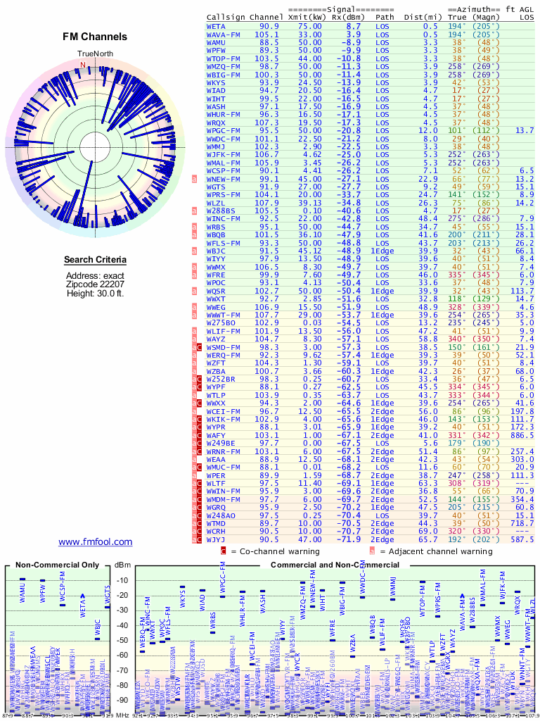

Additional trapping shouldn't be needed unless the station(s) are less than 1 mile away. I have 2 full power stations only 1/2 mile away, so the signals are over the top strong.
