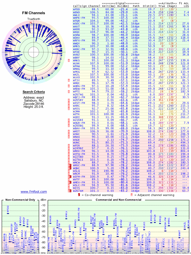

Any recommendations for a good quality FM Antenna based on the attached picture ?

Antennacraft Model: FMSS
http://www.antennacraft.net/Antennas/AntennasFM.html

Thanks again, is there any specific direction it would need to be pointed ? And would mounting in an attic work or best would be again outside chimney or mast mount of some sort ?

The FMSS is virtually omnidirectional.

Got the FMSS installed, seems to be picking up some good signals with it being installed in the attic, I would think it would get better on a mast outside.. Couple other questions though...
1. Is it alright to add another coax converter directly off of the antenna to run an additional line to a different location rather then using a splitter on the one line ?
2.With it being an omnidirectional would it make much of a difference if it was turned 45/90 deg either way , with one arm pointing in a higher signal area ?

1.) If "coax converter" means 75Ω/300Ω matching transformer (AKA: balun), I would advise against connecting a second matching transformer to the antenna terminals. To do so would place too low an impedance on the antenna thus changing it's tuning and ability to transfer signal power to the coax. Use a common 2-way splitter.
2.) There may be some subtle directivity, you can try adjusting the aim. Don't expect a great difference though.
