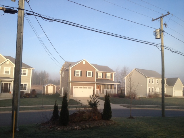

I attached the antenna to the side of the house and pointed it at approx. 308 degrees wrt true north. I was just using the compass on my iphone so I figure it is not completely accurate. I don't get any signal. I've fiddled with it a bunch and got nothing. I have attached a pic of my setup as well as what it is pointing to. It is pointing pretty much directly into some power lines so I assume that, if nothing else, those would interfere with the signal. Is that correct? Originally I wanted to put the antenna at the high point of the roof but I went up there and felt like my life was on the line lol so this is about the best I am going to do I think.

Background noise on VHF channels is common due to local power lines and other electrical distribution infrastructure. If it's present, it will wipe out the weak VHF signals from your northwest.
Unfortunately, it would take a spectrum analyzer to 100% identify if this is your reason for the "No reception" of WGAM's channel 8 signal.
If I am able to raise the antenna a bit more so that it is above the power lines (say 6 feet or so above them) and not pointing directly at them, will that get around most of the noise from the powerlines? Or do I need to be very far from them?

Installing a Tripod antenna mount on the highest part of the roof and installing the antenna above the mount will most likely get the antenna above the power lines.
