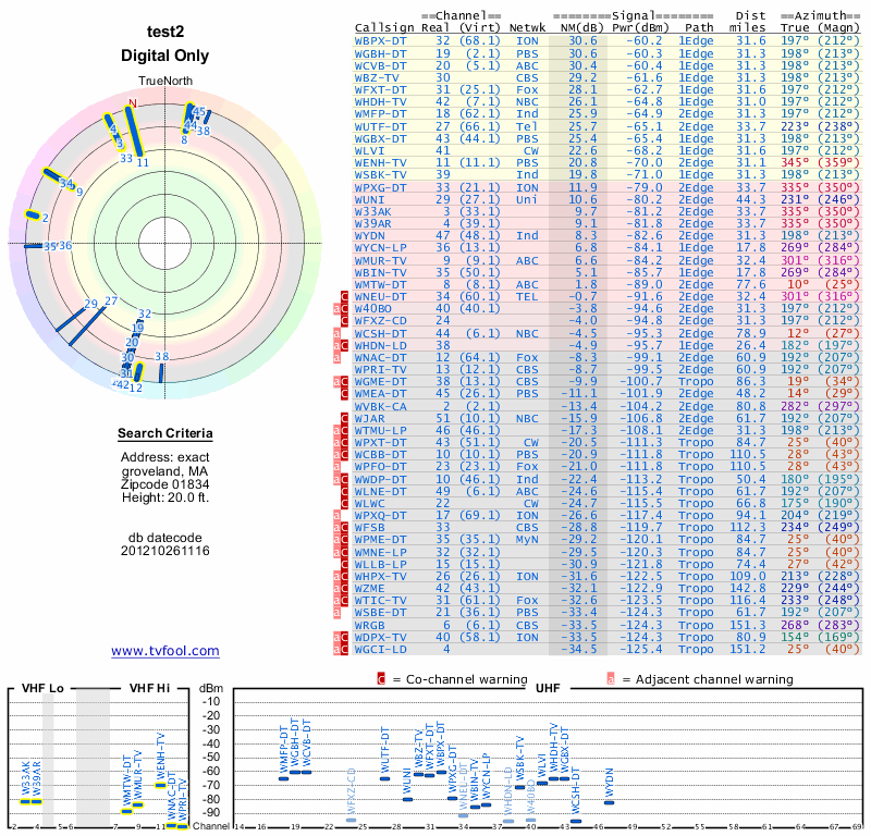

Hi, I would like to use the old existing antennae on my roof and I need some help determining what exactly is up there and some suggestions on upgrading the cables. I have attached a picture for reference, as well as the reception test. There is a two-prong wire from the lower antenna that I have my TV hooked into now. It runs about 30 feet into the basement, then as an experiment I hooked up a coax converter to it and ran temporary coax through the house to the TV. I get six channels, all under 11.x on my TV.

here is the report: http://www.tvfool.com/?option=com_wr...cc49754dda2d0f

Please post a live and active tvfool radar plot report.
Not a picture of a tvfool report.
http://forum.tvfool.com/dhowthread.php?t=4

here you go: http://www.tvfool.com/?option=com_wr...cc49754dda2d0f

A Simple reception situation.
This my - recommendation. As always you can make your own choices.
I recommend a new single antenna. 1 antenna solution.
For the Boston area Digital Tv stations/channels , above the roof install a Winegard HD7696P antenna aimed at about 212 degree magnetic compass direction.
Here are some above the roof antenna mounts , http://www.ronard.com/909911.html , http://www.ronard.com/34424560.html , http://www.ronard.com/ychim.html , http://www.ronard.com.
Buy the ronard antenna mounts at solidsignal by typing the word ronard in the solidsignal search box.
Here are some places to buy antennas and etc. , http://www.solidsignal.com , http://www.amazon.com , http://www.winegarddirect.com.
For 1 Tv connected use no splitter , no preamplifier.
For 2 Tv's connected use a common simple 2 way splitter , no preamplifier.
