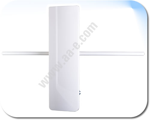

I use eagle star antenna($40) with kitztech preamp(earlier I used DB8 but i never got these many channels with that). I think kitztech preamp is making me loose weak channels.
With my current setup in the attic I can get following channels with antenna facing 160 degrees.
