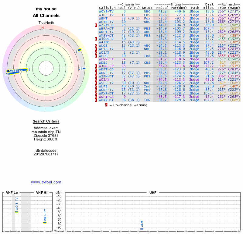

Radar-All.pngI have a rca 3036wr antenna mounted on my roof about 35 ft from ground, i have aska am125 ,25db distribution amp installed going to 3 way splitter to 3 tvs .I have 4/5 channels that are hit or miss . Any ideas how to improve my setup or something i have wrong. open to any ideas ,just hate to be watching something and lose the channel..lol thanks in advance for your help

Wow, you must have serious terrain challenges.
The noise margin (NM) says you need gain, lots of gain, at the antenna. That's got to be positive before it even hits the preamp.

In this case it appears reasonable to expect reception of the first three signals.
A Winegard HD7084P equipped with an Antennas Direct CPA-19 would be my choice of equipment if starting from scratch.
I would like to understand the terrain better. Because an image of the TV Fool report wast posted rather than an active link, it's not possible to click on the station call sign to see the path profile.
Also, can the antenna be mounted higher? Are there trees or buildings in the way of the antenna?

Thanks for the active link. When you click on a station call sign, you get a graphical display of the path profile... The transmitter is shown on the left, terrain cross section in the middle and your receiving location on the far right. Looking at WEMT as an example, you see the tall mountain ridge that blocks your line of sight toward the transmitter.
The HD7084P and preamp is still the best suggestion I've got. Higher is better no doubt.
