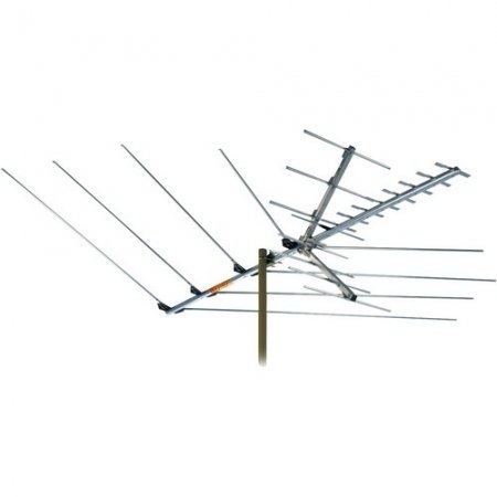

I'm basically looking to get as many stations as I can within reason.. I don't really want to spend more then $100 - $200 nor do I want a 400ft mast.. I would love to get KDKA so I can watch the Steelers when the Clowns play at the same time..
Also, would I need a rotator if I got a uni-directional antenna like the DB4/8 or the ClearStream4?
Currently I have an older boom antenna that I got from my inlaws because they don't use OTA. I have no idea what the make / model is but it's one that has the sides fold in which some have broken off. It's *similar* to
