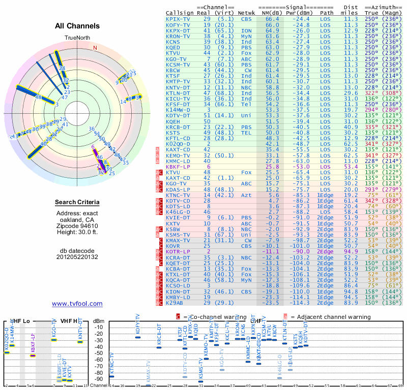

need help with reception
hi all,
i'm trying to figure out why i get great reception for some channels but not others. my radar plot is here: http://www.tvfool.com/?option=com_wr...073b9ed2be318a and also attached.
in particular, i'm frustrated with the poor reception i get for the various KQED channels - 9.1, 9.3, and KQEH 54.3. i'm especially confused since KQED is listed as being of comparable strength and in the same location, as other channels for which i get excellent reception. KGO, 7.1 and 7.2 come in really well, and consistently. but my reception for KQED channels seems to vary, with no obvious pattern. sometimes it comes in really well, sometimes it doesn't. 9.1 seems to come well more often than 9.3, but not often enough to be reliable. 54.3 which rarely comes in at all (but i see that its transmitter is in a different direction/location).
do channels with the same whole number use the same transmitter - is that why for example, 9.3 isn't listed separately? i would also like to get 32.4, one of the KMTP channels.
i live in a wood construction apartment building, on the top (third) floor. one thing is that i do have my TV, and antenna, somewhat in the interior of my apartment. to have the antenna near a window would require probably ~30 feet of cable, and spanning across multiple doorways (argh). but also, i did have it set up near the window at one time, and it didn't seem to make too much of a difference (my window faces southeast, while ).
i'm currently using a mohu leaf. i'm not sure if it was a smart change, because while for some channels i have improved reception (KNTV 11.1 and 11.2 i think), other channels stopped coming in completely (eg KOFY 20.1 ). before, i was using the philips SDV2710/27: http://www.p4c.philips.com/cgi-bin/d...ctn=SDV2710/27, which at least i could move around/turn more (while the mohu has to stay on my wall). any advice re: which one is better would be helpful too.

Do you have a balcony to the , south/east , south , south/west??
3 floors , lets say 10 feet per floor , that 30 feet.
Make a tvfool radar report plot with a antenna at 30 feet.

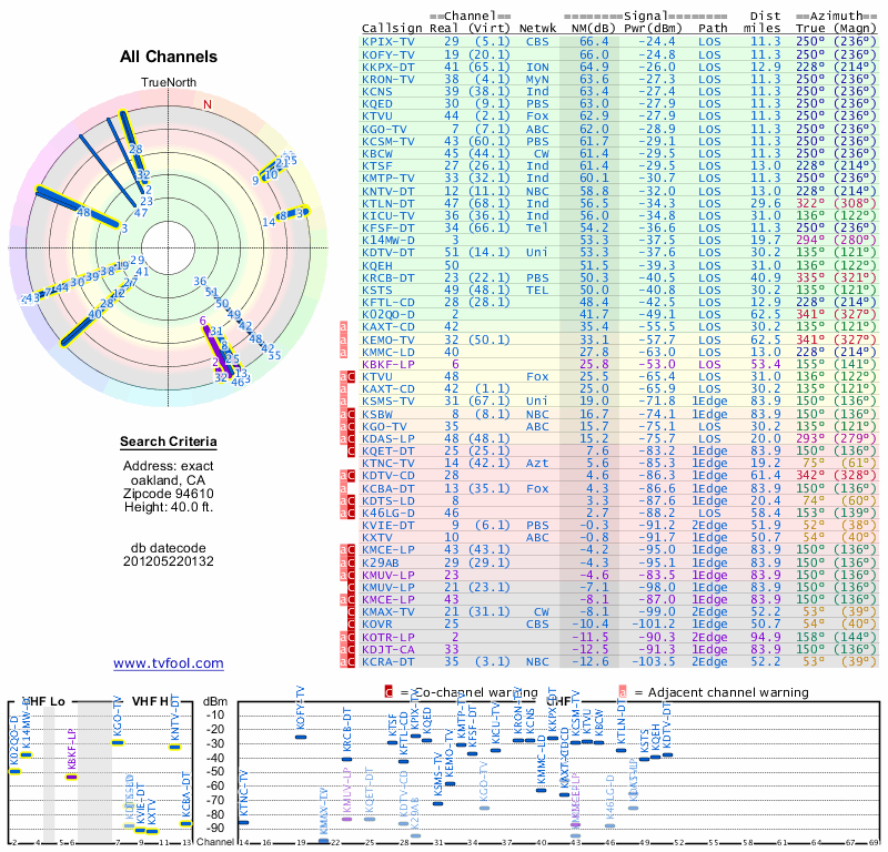

hi electron,
unfortunately, no balcony. the only exposures my unit has are to the southeast (two large windows).
re: antenna height - my ceiling heights are 8'. with two units below, and the antenna sitting either next to the TV or on the wall behind it, about 4' up, that's 8 + 8 + 4 = 20'. floor-to-floor is probably 9', so i think my antenna is probably no more than about 25' up. having said that, i've attached the radar plots for 30' (i could possibly reach 30' if i attached the mohu to the highest point on my wall) and 40' too, since you asked. :-)

Most of the Tv stations are to the south/east and south/west.
For a indoor antenna I recommend a Terk HDTVi antenna aimed at about 180 degree magnetic compass , in between the 2 groups of Tv stations to the south/east and south/west so as to receive the 2 groups of Tv stations.
Here is how to aim indoor antenna , http://www.kyes.com/antenna/pointing/pointing.html.
Best place for reception Will Be a south wall or a wall that is close to something like a south wall or window.
As to the multipul door ways , well.
There are rubber strips that go on the floor of door ways , the rubber strips have a channel through them so that extension cords , phone cords , coax cable can be passed across the door way.
Also do the buildings have satellite dishes outside??
Here is a Tv Antenna that looks like a small dish , On Purpose.
http://www.antennacraft.net/Manuals/HDX1000_manual.pdf.
If the HDX1000 is outside aim the HDX1000 at about 180 degree magnetic compass.
Here is how to aim outdoor type antennas , http://www.kyes.com/antenna/pointing/pointing.html.
Here are places to buy antennas and etc. , http://www.solidsignal.com , http://www.antennacraft.net , http://www.amazon.com.

It is best to make a live tvfool radar report plot like you did at first.
The attached images (pictures of the report) are dead , cant do any thing with them.

here's the radar plot for 30': http://www.tvfool.com/?option=com_wr...1349986dfd8f95
and 40', though i think it's not applicable to me: http://www.tvfool.com/?option=com_wr...1349351d7f4262
btw, i compared these side by side, also to my original 20' plot, and the differences seemed to me to be small - but are they still significant?
