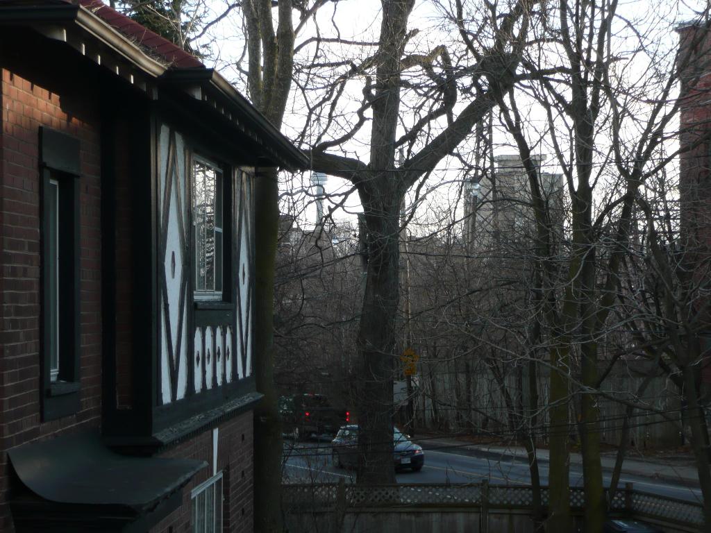

Hi there, I am in Toronto desperately trying to get WNED (43.1) from Grand Island near Buffalo, about 50 miles away. Here is my TV Fool report: http://www.tvfool.com/?option=com_wr...0b86425443283e.
I get all local stations but very limited reception from Buffalo. I have tested the following antennas in various directions: with a DB2 I get no Buffalo stations, with a CS2 I get 23.1 marginally, while a DB4e gets 23.1 and sometimes 26.1 and 7.1.
I suspect the problem is interference from some trees and part of a building obstructing my line of sight to Grand Island (if my photo appears below, Grand Island is to the left of the CN Tower in the middle of the photo, partly obstructed by the neighbor's roof). I don't know if adjacent channel interference is possible from a strong local CITYTV 44.1.
Since I am capable of WNLO from Grand Island, as well as WNYB from Jamestown and WKBW from Colden, both even further away, shouldn't I be able to get WNED (and Fox) somehow somewhere? I am guessing a reception breakthrough is unlikely with another of the same type of antenna, but I wonder about a strong directional antenna? Unfortunately I can't manage one of these 6'+ long yagis but if there is a more compact one worth recommending?

Have any of the antennas been mounted above the roof?? Can you mount above the roof?? The window in the picture is what direction?? WNED-DT Real channel 43 PBS is at 162 degree magnetic compass. Here is how to aim antennas , http://www.kyes.com/antenna/pointing/pointing.html. I recommend a Winegard HD9095P or Antennas direct 91XG antenna aimed at about 162 degree magnetic compass mounted above the roof with a good shot through the trees. Yes I know you said no 6 foot antennas , The HD9095P or 91XG have the gain that is needed for reception. You can call or E-Mail Antennas Direct and ask about the correct way to stack 2 DB4e antennas. Do not use a antenna amplifier with any of the antennas.

I really appreciate the responses, thank you! I should have said more about my installation. I do not have roof access at this point in time. The picture attached is from a deck where I can mount and where I've been testing antennas, including with a 15' pole. This is probably my max height which would put the antenna ~10' above the height the photo was taken. My cable is under 30' directly into a Panasonic TV with a decent tuner (no splitting). I am wondering then if amplification is even needed in my case?
For antenna positioning, I have been using the TV Fool bearing information as well as Google Earth. My line to Grand Island goes slightly over/through the neighbor's roof in the photo. I test off directions as well in case signals are bouncing around.
The solutions suggested, in addition to amplification, include yagi antennas and attenuating channel 44. Will the directional antenna will still give me a shot at 43 even if I cannot get above the trees or even above the roof next door? Is there any chance a smaller directional antenna like a RCA ANT751R or something between it and the mega-yagis can pull this off? And should my first step be yagi or attenuation (I can't do two yagis but maybe a trap or bandpass filter idea)?
In other words I just don't know which is the primary obstacle now, the tree+ interference or the adjacent channel. Keep in mind I already get one Grand Island station and one or two further away with the DB4e, but I cannot get two other Grand Island stations (only one of which probably has adjacent channel interference)!??!

The Primary Obstacle is the Trees And Roof/s. The DB4e Must Have a better look at UHF channel 43. Here are some antenna mounts that will get the DB4e Up Higher. http://www.ronard.com/34424560.html , http://www.ronard.com/ychim.html. Get the DB4e with no amplifier HIGHER then roofs and get a good clear shot through the trees and UHF 43 will most likely be received.
