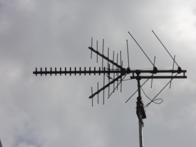

I went out and took the picture of my existing antenna.
It does have a balun on top and antenna itself looks quite decent. Looks like the problem is downstream. I am going to buy some cable and connectors to reach the tv in clean fashion and report back.

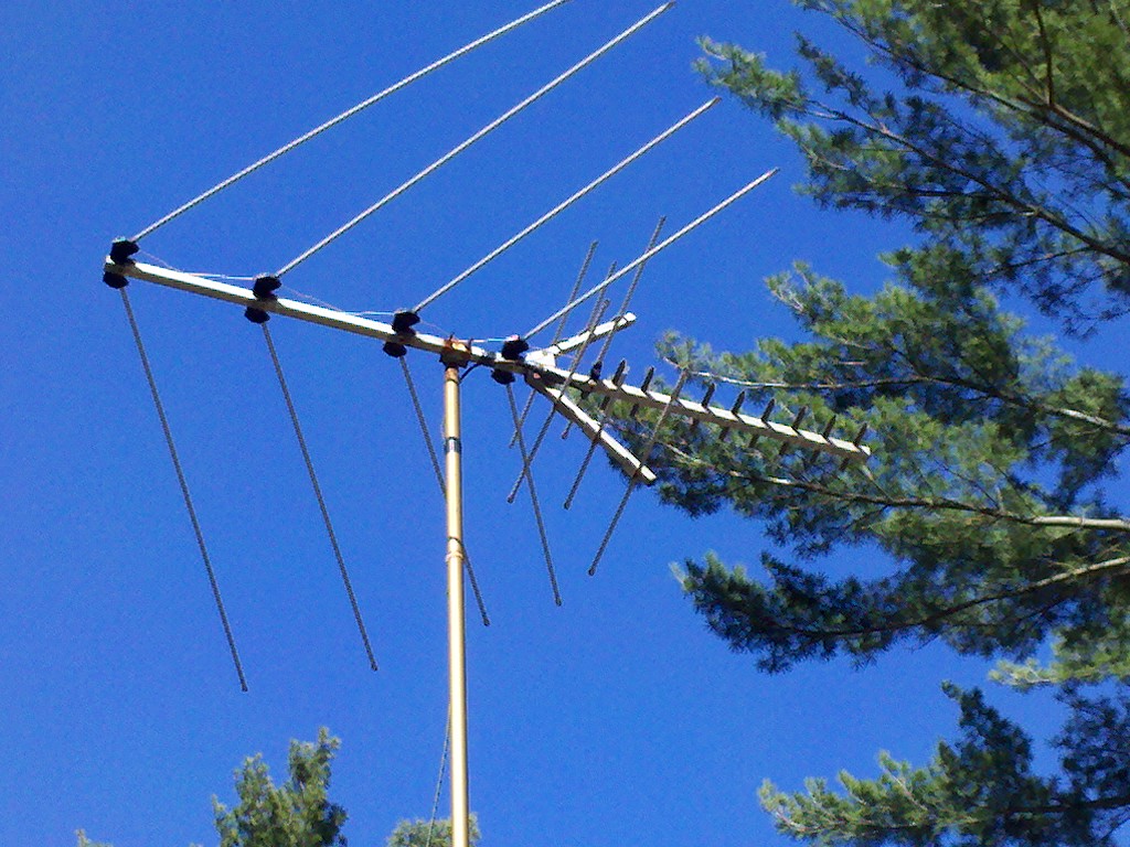

Bro That antenna seems very good for you area,go to Radio Shack and get a new balloon there is a golden plated one that costs more but it´s worth it and connectors,also god RG6 cable, i bought a new antenna and the balloon went bad in 3 moths
it gave me a head ache cause i never thought that the balloon that was new just got rotten inside,a mater of fact check my antenna link bellow that is very similar to yours after i remodeled it i live around Boston area a little farther north at Fall River and get most of the Chan from Boston,
i have also a indoor amp 24db and it has a turn switch that has - and + for more or less amplification, i have it closer to the receiver than the antenna and have to switch to minimun otherwise it cuts signal on some chan.
http://www.hdtvprimer.com/ANTENNAS/VU-190XR.html

As Electron said earlier, you can also get decent RG-6 cable and a balun at Home Depot and Lowe's. If you see a balun that was made in Japan, buy it (avoid gold plating)! Otherwise, no one balun stands out over another.
Your antenna is just fine for picking up Boston and Providence. It has a modestly wide range of azimuths where it is modestly to very sensitive to signals, so your aim does not have to be laser accurate for Boston. Since you have a VHF section, why not try to use it? I would start by aiming almost due south by a compass to get WNAC and WPRI. If you can get those plus all the stations in the green part of your report, then you're done. If you don't get them all, start stepping counter-clockwise 5 degrees or so until you get everything you want.
