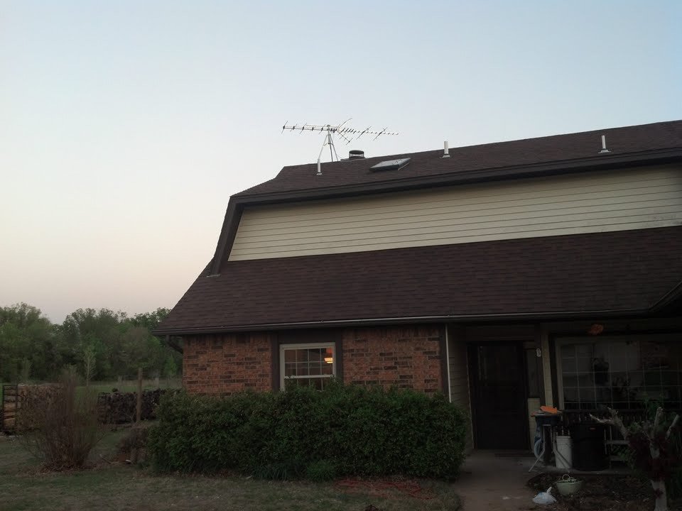

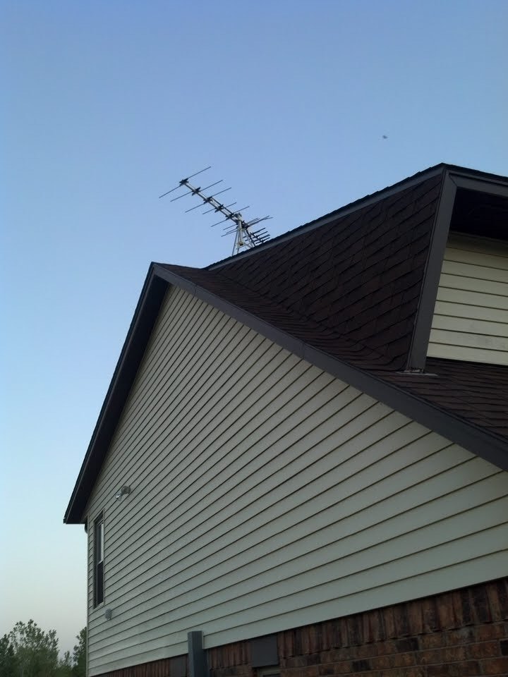

I got the antenna up on tripod, at the peak of the east end of house (~3ft from end), where there is the gable. The west end of the house also has a gable, and that is where the electric service is, in addition to where all the coax cables from the house all lead to.
There is about a 12"-18" overhang at both gables (east and west).
The roof is asphalt shingles, and the exterior walls have siding.
I installed the Winegard HD7697P directional.
As of now I have the coax temporarily running near the peak of the roof to the west side of house and connected to the cable coming into the house. I'm hitting 30 channels and very happy, but I need to finish this install.
I have dumped satellite TV today!!
Today, on the east end where the antenna is mounted, I attempted to feed the coax thru a hole I drilled in the soffit. Then, in the attic I drilled thru the end rafter and never hit air space after 6" of drilling. I hoped I was going to drill into the space in the eave, and be able to feed the coax from outside into the attic.
Any help is appreciated! Thanks a million --gopokes

The photos help immensely. Thank you.
Nice house... beautiful antenna
I own a 3/8" 'telephone' bit. It's about 24" long and is able to make it through several layers of framing, sheeting and siding when the need arises. I believe you can find such tools at Home Depot, Lowe's and similar stores. If not in the tool department, then the electrical department.
If you run the coax through the attic gable ends then down the west wall to meet the existing coax, run a #10 copper wire also. Connect the #10 wire to the mast/tripod and then to the electrical service ground. I assume there is a splitter on the outside at the west end. If so, verify it is connected to the electrical service ground with a piece of #10 copper wire.
(The #10 wire can be insulated or bare, what ever looks good or costs less, your choice.)
Your other option looks like running under the soffit which will add a bit to the length of the coax run.
