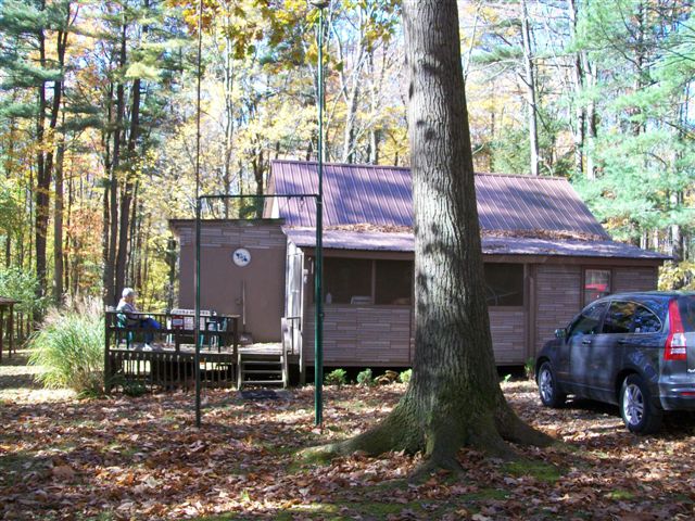

Here is picture of camp with woods surrounding it. Not a great picture but gives you an idea. My plan would be to mount antennae to the side of camp somehow near the peak of the camp on the right side of the photo. Which is on the north side.
Main TV transmitters are locate to the NorthWest...Approximately.
The trees are full grown and reach way above the camp.
I should also note a camp down the hill has a rather large antennae mounted outside there camp. I plan on visiting them in a couple weeks to see how they have there setup is and quality of channels, etc. They are half way down the hill and I would also guess the hill is blocking the TV transmitters from Erie, PA

Old 4-Apr-2012, 10:07 PM   #7
Electron
Join Date: Nov 2011
Posts: 1,832
Tv antennas and Tv reception
Install a Winegard HD7698P antenna , Up High , aimed at about 300 degree magnetic compass. Here is how to aim antennas , http://www.kyes.com/antenna/pointing/pointing.html Here are some antenna mounts , http://www.ronard.com/909911.html , http://www.ronard.com/antenna/pointing/pointing.html , http://www.ronard.com/ychim.html , http://www.ronard.com. Buy the ronard mounts at solidsignal by typing the word ronard in the solidsignal search box or buy from ronard. Here are places to buy antennas and etc. , http://www.solidsignal.com , http://www.winegarddirect.com , http://www.amazon.com , http://www.starkelectronic.com , http://www.3starinc.com.
