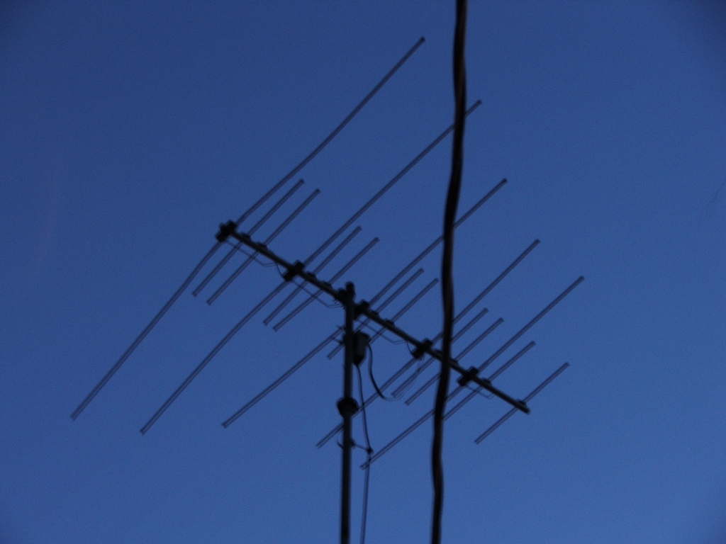

My current set up is rooftop antenna (picture below) 30 ft off ground, connected via a short 300 ohm wire to my preamp which is a Philips SWS2083W/17 Outdoor 28dB Antenna Amplifier (bought and installed in 2009). From there I am using RG6 to go into the house where it goes into a splitter and the power supply for the preamp. From the splitter it goes to two TV's, one using a RCA converter box and one using a built in tuner (Zenith Z50PV220 TV).

The antenna in the picture looks like a VHF only antenna. Most of the Tv stations/channels are UHF at your location. Install a Winegard HD7698P antenna with a Winegard AP8700 preamp aimed at about 305 degree magnetic compass. Here is how to aim antennas , http://www.kyes.com/antenna/pointing/pointing.html. Here are some places to buy antennas and etc. , http://www.winegarddirect.com , http://www.solidsignal.com , http://www.amazon.com

Thanks for the replies. After I had posted last night I continued to do more research and figured my issue was more about how good a signal my antenna was able to pull in rather than anything else.
It makes sense to me now that the antenna I currently have is a VHF only antenna, but it definitely gives me some UHF gain as without it I am dead in the water. So I am still curious if you have any idea how much UHF gain it would provide, hard to find any info on it since I have no idea what it is. Really just curious so I can compare it to other antennas.

A rough guess-ti-mate of the UHF gain would be between a few dB positive and as much as 10 dB negative. Expect the net gain to vary across the UHF band also. The positive NM figures shown in your TVFool report suggest that an antenna with negative net gain could successfully receive several signals, which seems consistent with the experience you're reporting.
The beam-width of the HD7698P is (over the majority of its bandwidth) about 40° (+ and - 20° from center). Aiming west or NW is consistent with your TVFR. Suggested aim point is just that, a suggestion and/or a starting point from which to fine tune the final aim.
I would expect you to see significantly better signal quality if you opted to replace your old antenna with the suggested Winegard. The AP8700 amplifier is also a good option, the Antennas Direct PA-18 is another very good choice, it's noise figure is a bit better.
