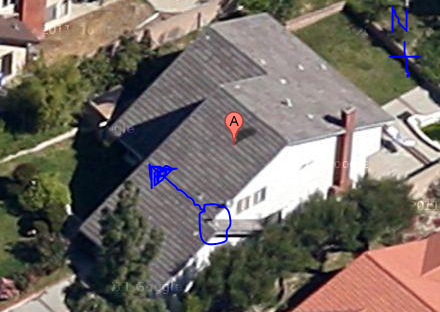

Thanks for all the help everyone. I received the antenna today and proceeded to set it up. I've gotten the antenna set up on my roof and have it connected to my 5-6 year old Sony TV. I used the leftover mount from an old DirecTV satellite that I had up there to mount the antenna along with some PVC pipe and tape. I used the pre-existing coaxial cable that was routed when the DirecTV satellite was set up to connect the new antenna to my TV. I also pointed it in approximately the 300-320 degree direction. Despite setting it up like this, I receive next to no channels.
The autoprogram feature on the TV was able to find around 20 channels, but almost all of them except for NBC are unviewable. There are a lot of channels that are like 18.1, 18.2, 18.3, etc, all of which have no signal. CBS has bad picture quality and the one local channel I really like, KTLA, is not discovered by my antenna. Only NBC works properly.
Does anyone have any tips on how I can get more channels?
Attached to this post is a picture of where I have the antenna set up and where it is pointing. North is shown in the compass in the top right.
Thanks!

Which make & model antenna did you choose? Did you also purchase an amplifier? If so, what make & model?
Just to be sure, here are diagrams that demonstrate how to aim various types of antennas: http://www.kyes.com/antenna/pointing/pointing.html (As I drive around, it's sad to see so many antennas aimed 180° or 90° away from the direction toward the towers.)
Some satellite system components look similar to over the air splitters but do not pass OTA frequencies effectively. Have you removed all such components?
Were the cable connectors sealed against the weather since the old satellite system was decommissioned? If water has entered the coax cable, it should be replaced. I'd suggest you get a new cable with connectors already installed, use it to test the antenna, simply run directly from the antenna to a single TV, through an open door or window, to verify your trouble is with the antenna, or the old satellite cable.
I see a chimney in your photo. That would be an excellent mounting option because it puts the antenna at a higher point, with a better view. Here's an example of chimney mounting hardware: http://www.3starinc.com/ez29-36s_y_c...a_bracket.html

Thanks for the reply. I'm using the Winegard 7694P antenna that I bought from Winegarddirect.com. The cables are in perfect condition because I only unplugged the satellite dish to install the antenna. I am not using an amplifier. Based on the picture I posted is the direction of where the antenna is pointing correct?
Ill see if I can mount he antenna on the chimney. Any other ideas?

The most reliable way to prove you have aimed correctly, is to use only one TV, one known good cable and the antenna. With one person adjusting the aim of the antenna and another checking reception at the TV, you'll want to sweep the antenna left and right in small steps to be sure you have the best aim. Use the signal meter on the TV if it's equipped with one.
This document http://www.winegard.com/kbase/upload/HD7694P.pdf includes a drawing of the antenna. The longest elements are at the back of the antenna. The drawing is as if you were standing in front of the antenna and a bit to one side. The front of the antenna needs to be closer to the transmit towers than the back of the antenna.
The aim depicted in your photo appears correct.
