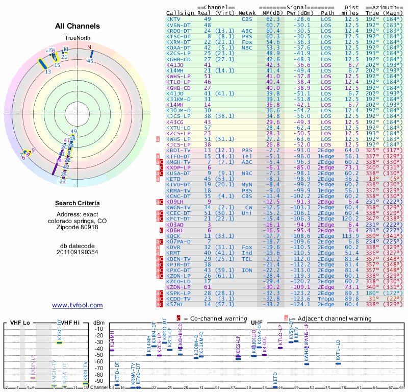

I have a ranch style home with a standard plywood sheet roof and clay tiles. I have easy access to the attic and there is plenty of room to set up an antenna. There are 3 tall pine trees in my front yard and a large aspen tree across the street that block my direct line of sight to the Cheyenne Mountain towers. I attached my coverage map to the post to give an idea of what my view is. I was thinking about installing a winegard hd7698p antenna in the attic and then running the coax into the basement where I have a splitter already installed from cable. The signal would feed 3 HDTVs throughout the house.
If the antenna is the right setup, does anyone have any recommendations on mounting the antenna in the attic (ca. 3-4 feet of clearance)? Do I need to buy an amplifier to boost my signal?
