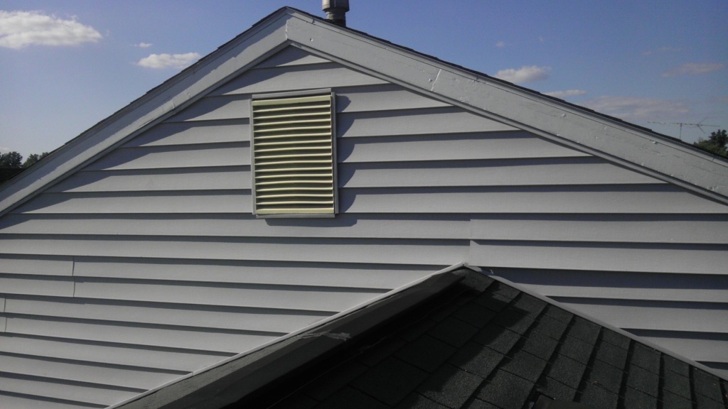

It looks like your TVFool report is based on the default mounting height of 10 feet. I would expect reception to improve at the height of the roof peak plus 5 feet. A tripod and 5' mast section would be in order.
You are correct, I kept it at the defaults. I measured, the peak of my roof is 20' from the ground. Here is the updated report (25'):
http://www.tvfool.com/?option=com_wr...9e7425f7b2e828
Pictures of the mounting location and the view southeast attached. Is a tripod mount the best option here, or should I use the side of the house and mount it higher?

A tripod will give you maximum mounting height.
A Eave Mount Bracket is also worth considering. http://www.3starinc.com/48_inch_eave...t_bracket.html
If you are strictly focused on reception of WXIN, the XG-91 remains the most reliable option. The Winegard HD769x series offers reception of the UHF channels as well as high-VHF (7 through 13)
