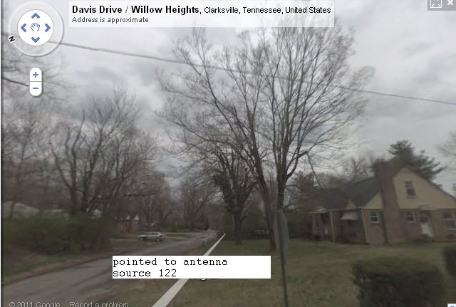

I live in clarksville, tn 35 mile from the nashville antenna source
tv fool plot
http://www.tvfool.com/?option=com_wr...3e47b508de05d7
I am thinking of buying a Winegard HD 9095P with a winegard ap-8700 amp.
I own a channel master 2016 with a cheap rca preamp mounted on the outside of the house. I only receive channel 2,17 (at 35-45 % power) in summer and channel 2,17,30,50 in winter at 65-75 % power.
we have very tall tress in clarksville.
Luckly channel 5 (wtvf) is going soon to 1000kw full power license on real channel 25.
i do not care about any vhf channel
just want to improve my ufh
Channel 2,5 (25 new),17.30,58
someone told me that the double stacker was the best on the market
http://www.dennysantennaservice.com/
is this true ?????
any suggestion or help would be high appreciated
kurt b.
or is their any better antenna i can use
my budget is no more than $300
thanks all

The hd slacker is Not the best on the market. There is no one antenna that is the best at every thing. . I recommend a Winegard HD7698P antenna with no preamplifier. Aimed at about 131 degree magnetic compass. The antenna will need to be above the highest point of the roof. Here is how to aim Tv antennas , http://kyes.com/antenna/pointing/pointing.html

The tvfool radar report that is posted is the default antenna height of 10 feet and shows good reception. For better reception mount the antenna about 3 to 5 feet above the roof and reception should be fine. The reason you see a lot of these antennas is because they are the correct antenna for the reception of the Tv stations channels. I go to great lengths to recommend the correct antenna. It is Always best to clear the roof by a few feet when mounting a antenna. Here are places to buy Tv antennas and etc. , http://www.solidsignal.com , http://www.starkelectronic.com , http://www.amazon.com
