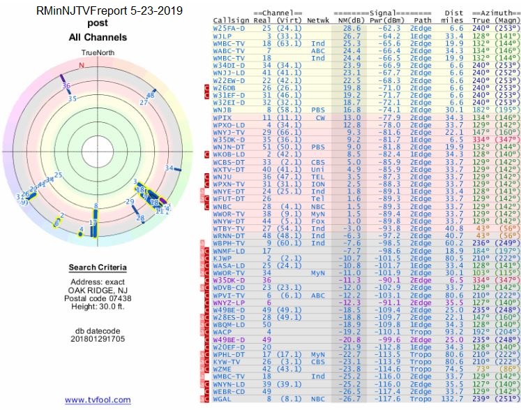

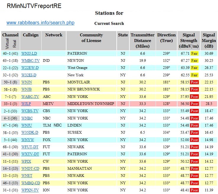

Hello, RMinNJ
This is an image of your TVFool report:
This report from rabbitears.info probably has a more accurate list of channels:
I agree with the previous advice: you will need a separate VHF-High antenna and preamp for 7 and 11.
