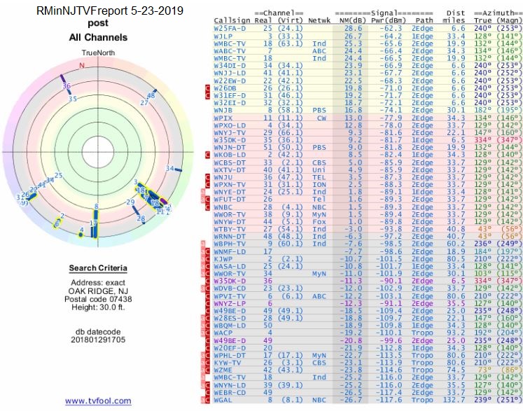

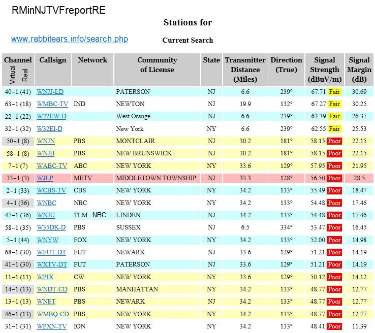

rabbit73 24-May-2019 3:10 AM
2 Attachment(s)
Hello, RMinNJ
This is an image of your TVFool report:
https://forum.tvfool.com/attachment....1&d=1558663771
This report from rabbitears.info probably has a more accurate list of channels:
I agree with the previous advice: you will need a separate VHF-High antenna and preamp for 7 and 11.
https://www.newark.com/stellar-labs/...vhf/dp/48Y8141
a little more gain:
https://www.newark.com/stellar-labs/...nna/dp/71Y5462
