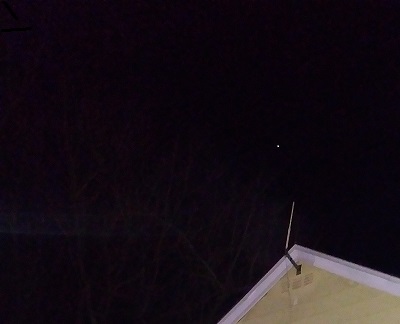

this is the antenna i'm talking about if the picture shows up if not maybe someone can help me figure the picture out. thanks
Thanks for the interesting antenna photo. Can you zoom in closer?
I think Tower Guy is correct when he calls it a slot antenna, but probably not a skeleton slot antenna. The slots are vertical, but the polarization is horizontal. A skeleton slot antenna has a vertical loop that is the driven element for a vertical stack of 2 yagis with directors. What is unknown, is how directional is the antenna.

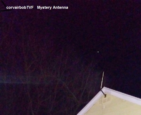

i will see if i can chop it closer for you. see if this works better if not i will retake it but i can't get any closer.
as far a directionality where we live we have stations to the north east and south east and it get them all real good. some days she gets pixelation on the stations that are like 40 miles away but for the most part she says it does a good job. i used it at my house 2 years ago and it did not add anything to my channel selection. but now that we have all talked about this it may have been the other antennas were canceling out this antennas ability to add to the pot.
i then tried it last summer by taping it to a pc. pipe and leaning it against the front of my house and i got all the stations but they were iffy at the most they worked some days and then other days some when away, thank may have been due to not being up on the roof. so what i want to do is get another one but bud died and i have no clue about this. so this spring i guess i will have to take this one apart and see how it is made and then make a few more.
https://en.wikipedia.org/wiki/Slot_antenna
try this now and see if it look larger. quality is not as good but you should get the idea.

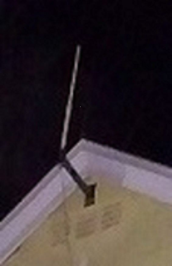

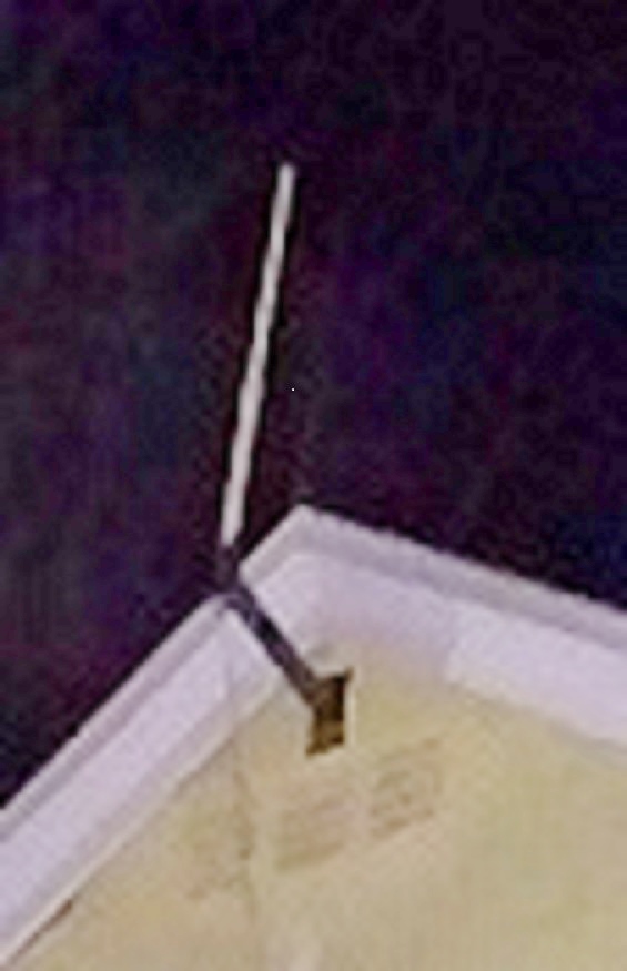

Thank you. Yes, you can enlarge and crop it, but you lose detail. You would need a zoom lens on your camera to get closer without needing a ladder so that there would be more pixels for better detail.
that larger picture i send show it as it is only a bit fuzzy i will try to get a better on but that will happen next week when i'm at the house. i will try to zoom in on it better. but even in the last picture there is not much to show. it is just a section of cpvc and the coax coming out of it. inside the cpvc there has to be wire but how it is positioned anyone's guess.
That is true. Even if the detail was better, we still wouldn't
know what was inside.

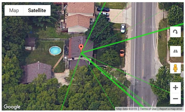

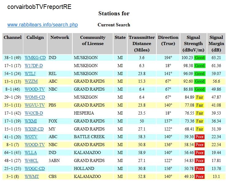

It is possible that there is interference between the antennas; combining antennas aimed in different directions with a splitter in reverse doesn't always work. If you don't have all the channels after combining that you had when the antennas were separate, that method of combining doesn't work for you.
With all those trees in the signal paths, why do you expect good reception? Trees block TV signals.

i get 13 17 29 35 54
i do not get 8 nd if i seperate the antennas it is worse than combining them. the photo that shows the antenna is the south antenna i have one on the north end the north end points to the north and east the south one points the east and south.
the pvc antenna on my girls house is on the east side of her roof at the peak. it gets 8 13 17 29 35 54 but 35 and 54 are sometimes iffy. i think if i put on an amp that will improve. thanks
