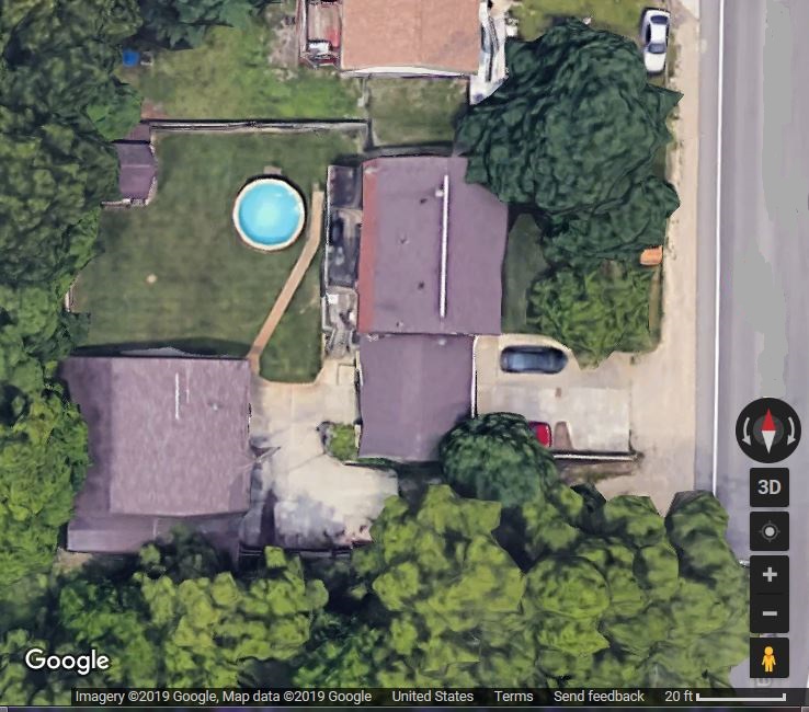

rabbit73 9-Feb-2019 8:11 PM
4 Attachment(s)
Originally Posted by corvairbob (Post 60749)
thanks just so you know so far my girl still gets tv 8 from that pvc type antenna. i do not get tv 8 at all with my setup. i think that is due to some type of interference between the antennas. i do get 29-1-2-3 so this spring if tv 8 stops showing then i will rescan and see if it improves.
It is possible that there is interference between the antennas; combining antennas aimed in different directions with a splitter in reverse doesn't always work. If you don't have all the channels after combining that you had when the antennas were separate, that method of combining doesn't work for you.
http://forum.tvfool.com/attachment.p...5&d=1549742190
With all those trees in the signal paths, why do you expect good reception? Trees block TV signals.
Scroll down to Trees and UHF
http://forum.tvfool.com/attachment.p...6&d=1549742300
http://forum.tvfool.com/attachment.p...1&d=1549742456
http://forum.tvfool.com/attachment.p...9&d=1549743511
corvairbob 9-Feb-2019 8:17 PM
i get 13 17 29 35 54
i do not get 8 nd if i seperate the antennas it is worse than combining them. the photo that shows the antenna is the south antenna i have one on the north end the north end points to the north and east the south one points the east and south.
the pvc antenna on my girls house is on the east side of her roof at the peak. it gets 8 13 17 29 35 54 but 35 and 54 are sometimes iffy. i think if i put on an amp that will improve. thanks
