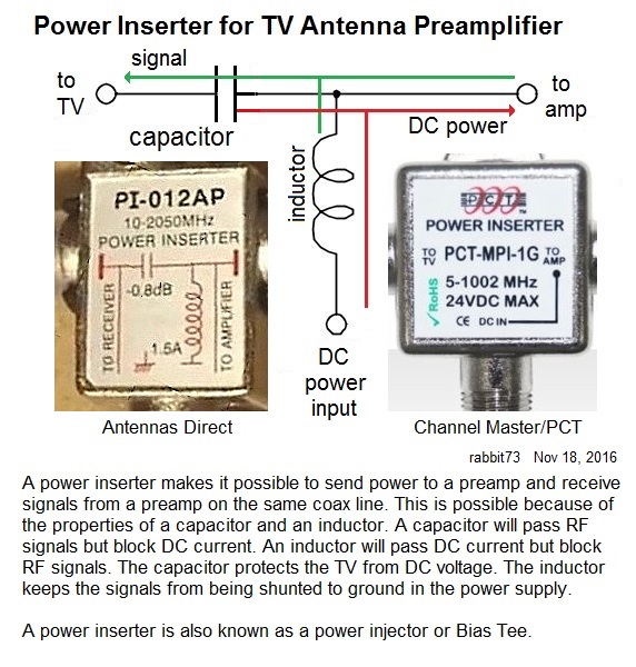

Not sure what you mean by a power inserter

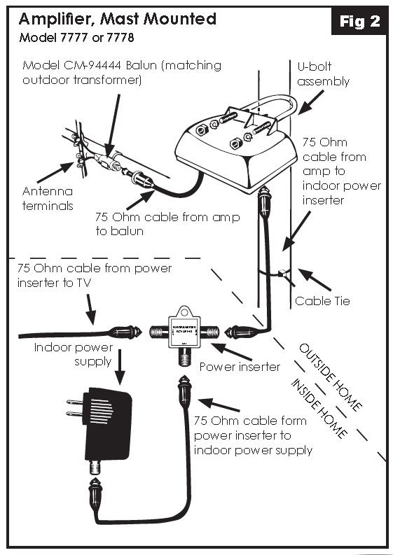

The power inserter is part of the preamp system. It makes it possible to send the DC power up to the preamp AND send the signals down to the TV on the same coax line.
https://www.channelmaster.com/TV_Ant..._p/cm-7777.htm
manual
http://downloads.channelmaster.com/S...77_7778_UG.pdf

I have new coax laying around, I may try that today. As for the power inserter, yes I have that, came with the cm-7777.
