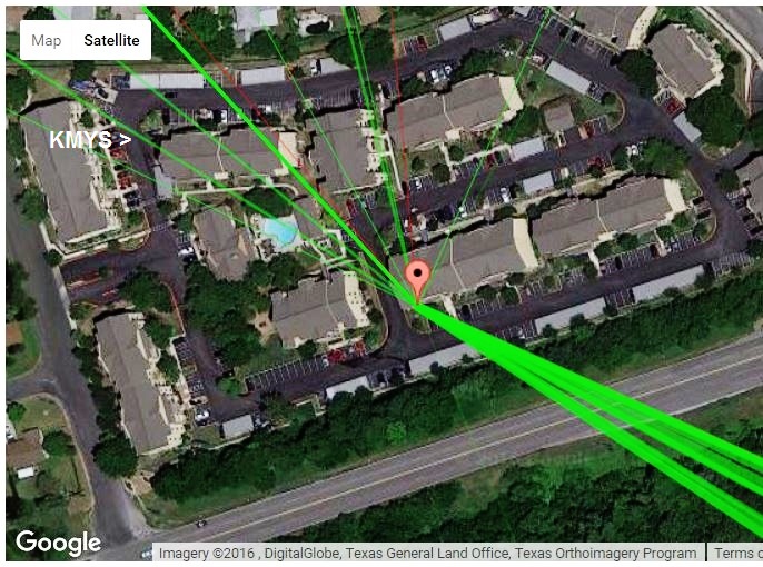

Reception indoors can be difficult. Your tvfool report shows very strong signals, but it assumes your antenna will be outside and in the clear.
Are you using your Mohu Leaf 50 with or without the amplifier?
What floor is your apartment on?
What side of the building is your apartment on?
Do you have a window that faces SE or NW?
When are you moving, and what will the new location be like? I'm thinking about equipment that you buy now, being used there.
Without any further information, I suggest the Antennas Direct C2V antenna. It is a directional antenna, so it must be aimed at the transmitter.
KMYS would be a real long shot, because it is much weaker than your local channels. It would require a high gain UHF antenna aimed at 297 degrees magnetic. You probably would not be able to use a preamp because it would be overloaded by your local channels.
To make a more accurate analysis, I would need to look at a satellite view of your building. You would have to do it with the tvfool interactive map or give me the coordinates in a PM. It would look something like this:

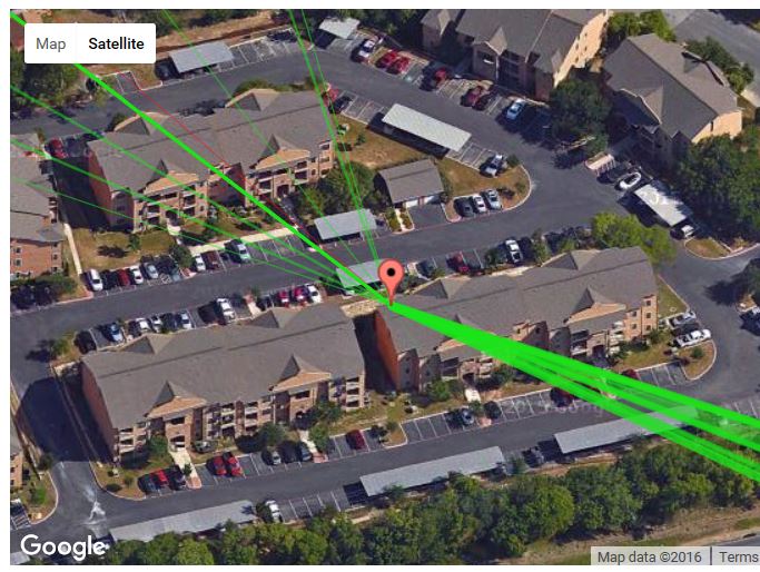

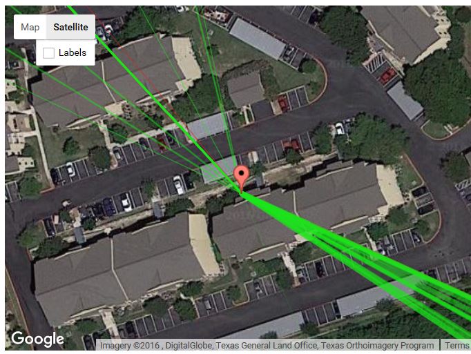

Thank you for the additional information. I think you must have used the bird's eye view
instead of the vertical
In any case, it looks like your local strong signals have to go through the building to get to your antenna. The C2V would still be suitable. Try different locations in your apartment, extending the RG6 coax if necessary.
If you put a high gain UHF antenna like a DB4e in a NW window (no metal screen or low-E glass) for KMYS, the signal might be blocked by the building across the parking lot. It's up to you if you want to experiment.

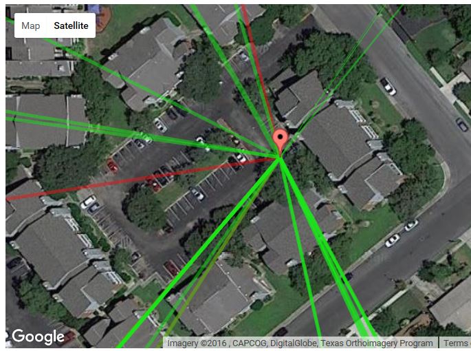

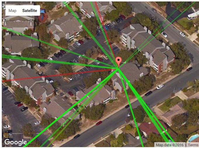

I'm glad that the C2V is working for you.
The signals at the new location are a little less strong; in particular KLRN PBS 9 and KSAT ABC 12. KCWX MyN 8 is a lot weaker. KMYS CW 32 (35.1) is a lot stronger, but still in a different direction.
I think the C2V would be better than the FV-30BB at the new location, but indoor signals are difficult to predict because of differences in construction. The C2V has more UHF gain than the FV-30BB, but about the same gain on VHF-High for PBS and ABC.
It looks like the signals will still have to go through the building to get to your antenna. As before, try different locations. The antenna aim should be about 150 degrees magnetic.
Trees block TV signals.

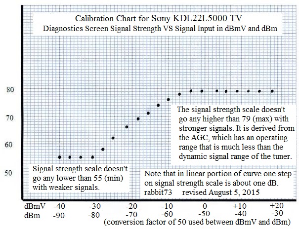

Thanks for the additional readings. KSAT 12.1 seems to have readings similar to the other channels, so the problem might be multipath reflections and not signal strength.
Signal strength readings are relative, so I don't know the normal range for good signals with your TV.
The Diagnostics Screen for my Sony KDL22L5000 goes from 55 to 79.
Bad signal with picture freeze, SNR below 15 dB, and errors:
Good signal:
My newer Sony KDL32R400A has a much wider range of signal strength readings:
I was going to suggest a medium gain amp like the CM 3410, but you said a preamp didn't help.
If grounding the coax shield, an FM trap, and a reflector behind the dipole don't help, the only thing left would be a VHF-High antenna with more gain to replace the vhf dipole kit.
