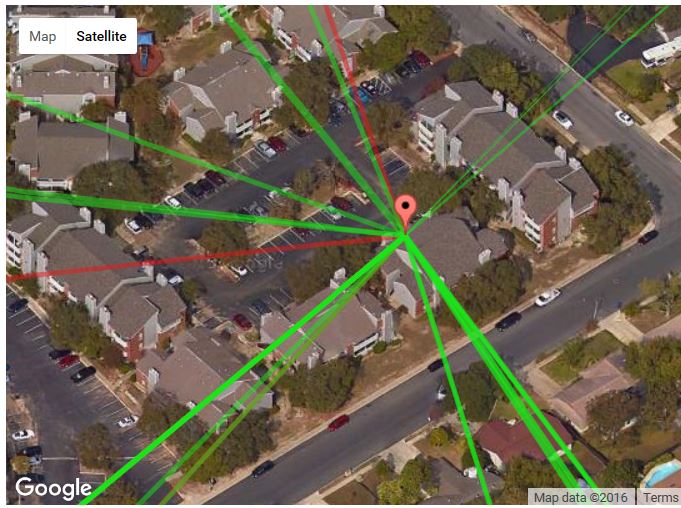

Reception indoors can be difficult. Your tvfool report shows very strong signals, but it assumes your antenna will be outside and in the clear.

Without any further information, I suggest the Antennas Direct C2V antenna. It is a directional antenna, so it must be aimed at the transmitter.
KMYS would be a real long shot, because it is much weaker than your local channels. It would require a high gain UHF antenna aimed at 297 degrees magnetic. You probably would not be able to use a preamp because it would be overloaded by your local channels.

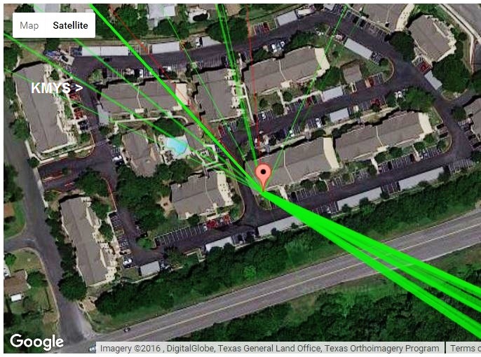

To make a more accurate analysis, I would need to look at a satellite view of your building. You would have to do it with the tvfool interactive map or give me the coordinates in a PM. It would look something like this:
http://forum.tvfool.com/attachment.p...1&d=1477251131

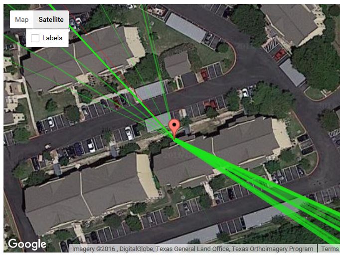

Thank you for the additional information. I think you must have used the bird's eye view
http://forum.tvfool.com/attachment.p...1&d=1477269560
instead of the vertical
In any case, it looks like your local strong signals have to go through the building to get to your antenna. The C2V would still be suitable. Try different locations in your apartment, extending the RG6 coax if necessary.
If you put a high gain UHF antenna like a DB4e in a NW window (no metal screen or low-E glass) for KMYS, the signal might be blocked by the building across the parking lot. It's up to you if you want to experiment.

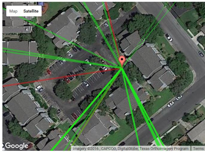

Here is one of my perspective places to move.
http://www.tvfool.com/?option=com_wr...dfaf2cd436ecd7
coordinates are 29.541123,-98.409196
I'm going to asked to be placed on the first floor and was wondering would the C2V work there or would the FV-30BB or something better? I guess what I'm asking is should I return the FV-30BB or when I maybe/might move in buy a different antenna?

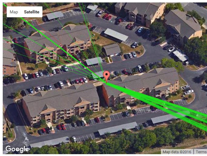

The signals at the new location are a little less strong; in particular KLRN PBS 9 and KSAT ABC 12. KCWX MyN 8 is a lot weaker. KMYS CW 32 (35.1) is a lot stronger, but still in a different direction.
I think the C2V would be better than the FV-30BB at the new location, but indoor signals are difficult to predict because of differences in construction. The C2V has more UHF gain than the FV-30BB, but about the same gain on VHF-High for PBS and ABC.
It looks like the signals will still have to go through the building to get to your antenna. As before, try different locations. The antenna aim should be about 150 degrees magnetic.

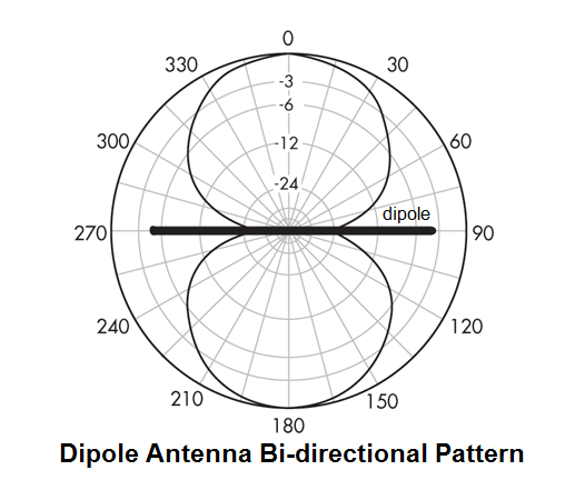

The C2V VHF dipole has less gain than the UHF loops. It is also bi-directional which means it might pick up multipath reflections from the rear.
http://forum.tvfool.com/attachment.p...1&d=1478288508
You can cover a piece of cardboard with aluminum foil and use it as a reflector about 14 inches behind the VHF dipole to make it more directional and have a little more gain. If that doesn't work for 12.1, the only other thing I can think of is to use a separate VHF antenna combined with the C2, instead of the dipole, that is more directional and has more gain.

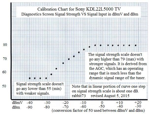

Thanks for the additional readings. KSAT 12.1 seems to have readings similar to the other channels, so the problem might be multipath reflections and not signal strength.
Signal strength readings are relative, so I don't know the normal range for good signals with your TV.
The Diagnostics Screen for my Sony KDL22L5000 goes from 55 to 79.
http://forum.tvfool.com/attachment.p...1&d=1478736496
