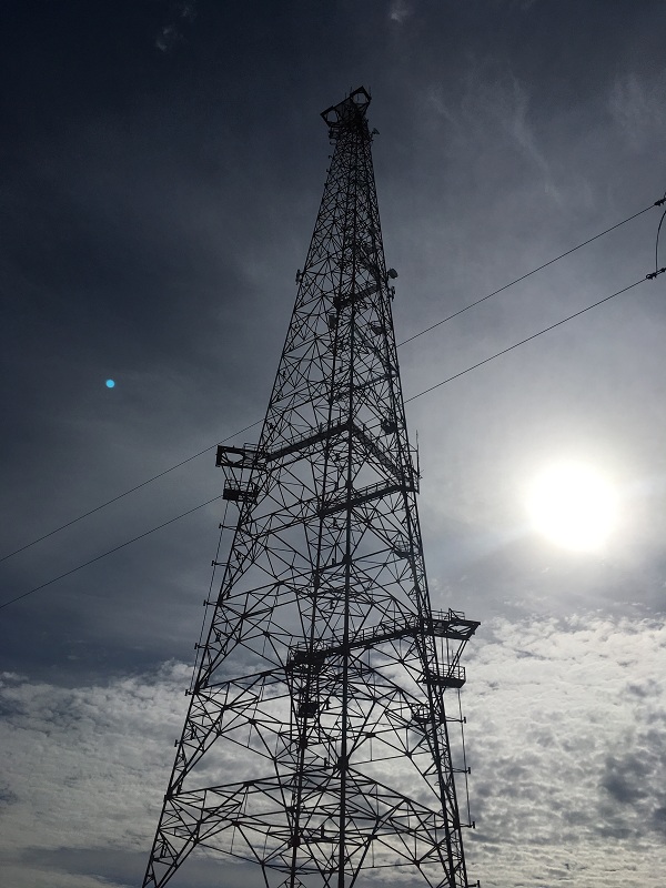

It appears they have rectified whatever issues they were having with the transmitter in Louisburg. Friday night, channel 22 (virtual 25) lit up with 100% signal strength and signal quality on my HD Homerun OTA tuner. Not sure what was wrong before, but at any rate, it's working GREAT now and it's added 12 channels to the over-the-air lineup for thousands of people in the extreme south Kansas City area/northern Southeast Kansas area. Turns out the tower is only 9.2 miles from my house, so I drove up there Saturday morning and took some photos of the tower.
