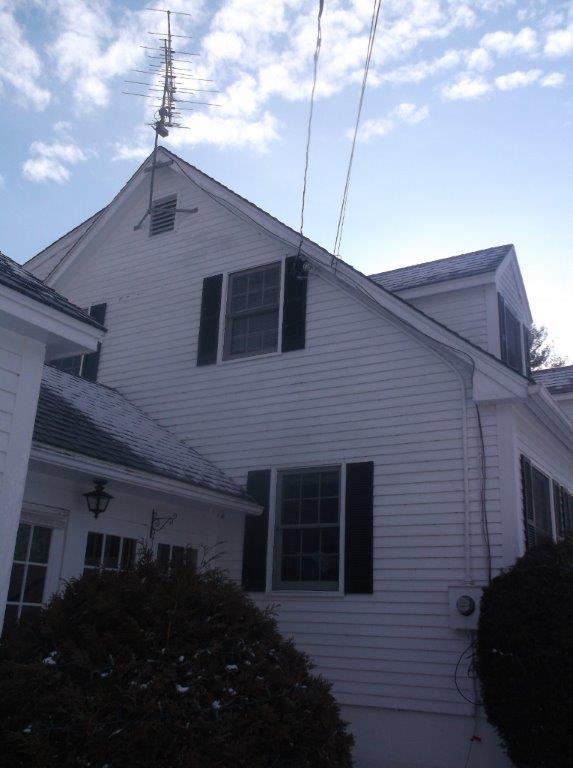

Eventually, I would like to feed 3 TVs. Over the last 8 months or so, I have been experimenting with four antennas, all with fairly similar results in one key aspect, specifically, the inability to reliably receive WCAX. The antennas are (Denny's HD Stacker, CM-5020, HDB91X, and a homemade 8-foot K7MEM yagi designed for UHF ch-22).
In general, in 5-foot AGL tests with the TV very close to the antenna (4-feet of RG-6, no pre-amp) and the antenna pointed to 342-deg, I can get WPTZ fairly reliably, with spotty pick-up of WCAX. By "spotty", I mean if I move the antenna 5-feet to the right or left it can make the difference between 40% signal for WCAX and nothing. Oddly enough, in some locations I can receive WCAX at 5ft-AGL, but when I raise the antenna tripod up to 8ft-AGL, reception dies, until I move to the right or left about 6 feet. I have confirmed that this is a spatial anomaly somewhat repeatable from day to day, not a temporal one. Very strange behavior, but I figured it would go away when I permanently mounted the antenna on the roof at 30ft.
Not so. I moved the antenna to a gable-end mount at 30-ft AGL, with a CM-7778 pre-amp and 35-feet of RG-6 and an earth-ground-block for the coax-shield now part of the setup. I figured that WCAX should come in reliably, and I would have a decent shot at the rest of the channels on my list. Well, I am able to get WPTZ, WVNY (Hi-VHF, so only receives via HD Stacker and CM-5020), and WETK reliably, and even occasionally WFFF (especially with the HDB91X). But regardless of antenna, I cannot seem to get WCAX reliably, even though it has a relatively easy NM=8.2 dB, compared to the other UHF stations that I am receiving that are lower down on the list WETK (NM=-2.2) and WFFF (NM=-5.8).
WCAX is a priority for me since it is CBS affiliate and it carries the local NFL team. Why am I not receiving WCAX? I have a few ideas, such as (1) my down-lead comes in right underneath my electrical meter, and (2) a transformer is about 100-feet away from the antenna at about 325 degrees. Could either of these be causing interference? Any offending trees are at least 300 feet away, and about 50-feet tall. If this is a multi-path "null", would an antenna with a wider capture area (e.g. DB8e) improve reception of WCAX? I suppose I could try mounting the antenna somewhere else on the roof (either on the garage gable ends, or on the middle of the roof ridgeline using a tripod) but the wife thinks it is least-offensive on the gable end of the house, since it is "balanced" by the chimney on the other end of the house. I prefer not to mount it to the garage roof, since doing so would impede reception of some other lower-priority channels to the southeast.
Thanks in advance for any help you can offer!

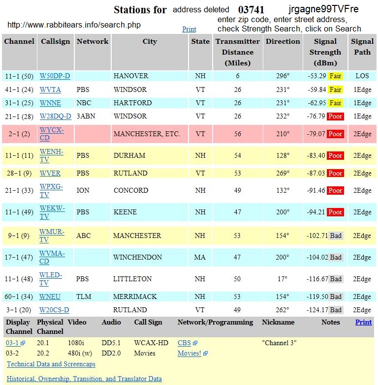

Is it possible you are receiving the WCAX translator, W20CS? It has the same virtual channel number. Do any of your TVs give the real channel number or frequency of a received channel in the menu?

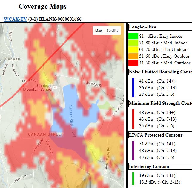

It is curious that it is one of the only signals on my TVfool report that does not have a birds-eye-view signal strength plot available for it.
Yeah, I noticed that the coverage map was not available from the tvfool Interactive Map Browser. That made me wonder if it was really on the air. I did find a Longley-Rice coverage map on the FCC contour map:
http://www.rabbitears.info/contour.p...2.816111111111
Red is weak, no color is weaker. You can see the coverage in your area is very spotty because of the rough terrain. A small change in location can make big difference in signal strength.
I'm pretty sure it is not W20CS. With my TV in "manual" mode, when I type in "22" it automagically goes to 3.1. If I type in "20", it stays put and says "no signal". Unfortunately, the other TV is the same type, only smaller, and all the menus are exactly the same. They are circa-2008 Sylvanias.

Tomorrow, I will try to post a picture of what the antenna "sees", to see if the you think the power line occlusion/obfuscation may be at play.

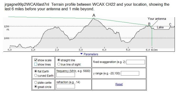

This is the terrain profile for WCAX from tvfool:
http://www.tvfool.com/?option=com_wr...dALLTV%26n%3d7
This is the profile using different software:
The WCAX signal passes over two ridges, which causes scattering, resulting a non-uniform field as you saw on the hdtvprimer page. Point A is further out; point B is just before your antenna. I can see the ridge at point C behind your house. Using "what if" height changes on the interactive map browser:
At 115 ft 1Edge NM 17.6 dB; the signal clears point B
At 485 ft LOS NM 41.0 dB; the signal clears point A
What bothers me is, if the terrain affects WCAX, then why doesn't it affect WPTZ?
I suggest you hunt for a good location for WCAX (somewhere on you property even if it means a mast behind the house) using the HDB91X with the front of the antenna tilted up (15 deg ?) to catch the signal coming down from the ridge. You need to get the antenna as high as you can because there is a lot of ground clutter on the hill just in front of the antenna.
My house is actually situated right on the boundary between Orange and No Color. But the my ground tests were typically in the yard or driveway, which are in "Orange". That, coupled with the ground bounce, probably explains my spotty ground reception, yet poor roof-top reception.

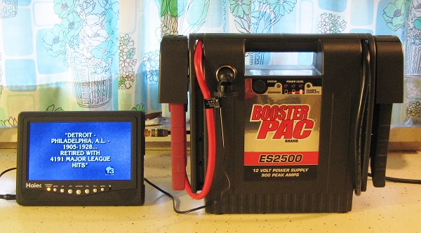

If I do "walk the roof" and happen to find a hot spot for WCAX, do you think the hot spot will stay in the same place from day-to-day, and over the seasons and years?
The hot spot stayed stable for me. My wife wanted a battery operated TV for use during a power failure. The only place it would work indoors with analog TV was by a window.

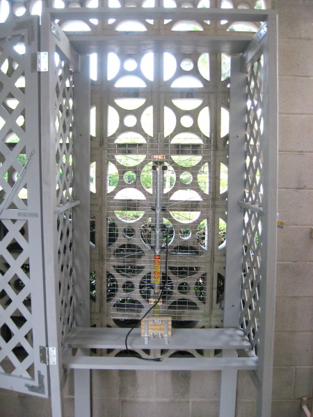

When digital TV came along, an indoor antenna would not work because there was an aluminum foil vapor barrier on the insulation in the outer walls; we were living in a Faraday Cage.
The landlord said I could mount an antenna outside if it did not show from the street. I selected a hot spot inside the decorator blocks on the porch. The landlady said she wanted me to move it to the left where it wasn't as obvious. I explained to her that the antenna needed to be where the signals were the strongest, and I would build an attractive enclosure for the antenna. She said OK.
The 4-bay UHF antenna is about 5 ft off the ground. I added a folded dipole for VHF channel 13. The signals come through the holes in the blocks without much attenuation. The VHF signals are attenuated a little more because the size of the holes is frequency related. In other words, the holes act like a high pass filter.
