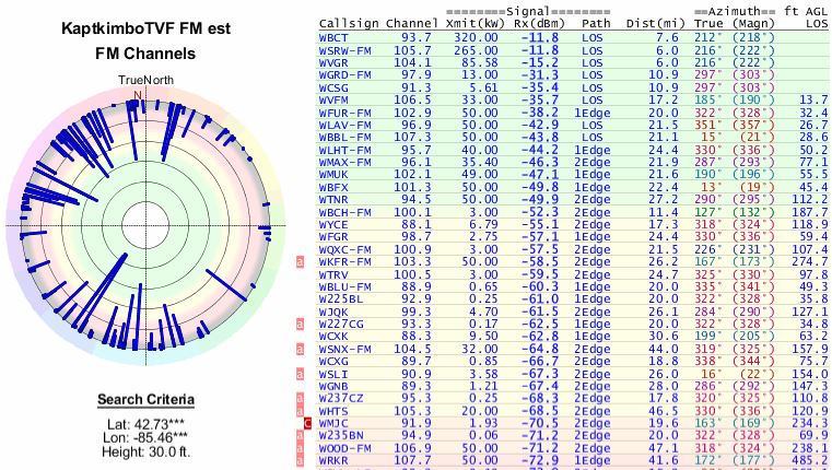

While you are ordering, I suggest you order an FM trap/filter. Your FM signals are even stronger than your TV signals, and might interfere with TV reception. See attachment.
http://www.mcmelectronics.com/produc...804247%2Cd.cGU
http://comingsoon.radioshack.com/rad...p/1500024.html slow link
