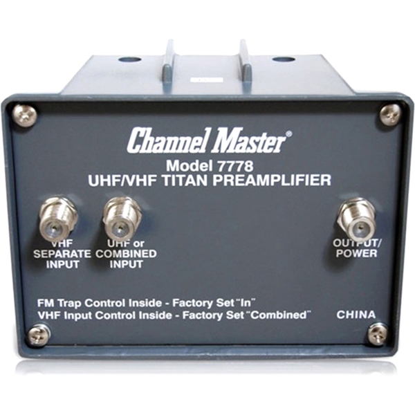

Which CM7778 is it, the old one with separate inputs for VHF and UHF, or the new 7778 with just one combined input? See attachments.

The CM 7778 is the new one. I couldn't get any signals to my TV till I installed the pre-amp even though I'm close to stations Link to TV fool report...hope this is correct
