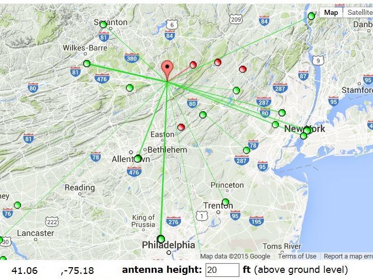

I can reach NY, Philadelphia, and Wilkes Barre with my 1980's large directional antenna depending on which direction I point. I can get ABC in all locations, CBS in NY, and Wilkes Barre, and NBC in Wilkes Barre only. I cannot get Fox anywhere with this antenna. How good is Denny's antenna? Is there any better for me? We cut the cord last year and are trying to spend some of the saving on a better antenna.

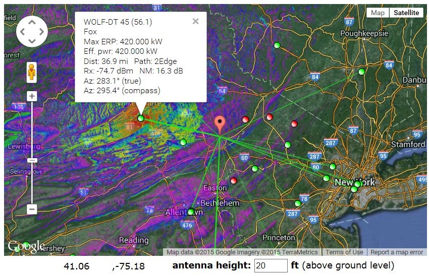

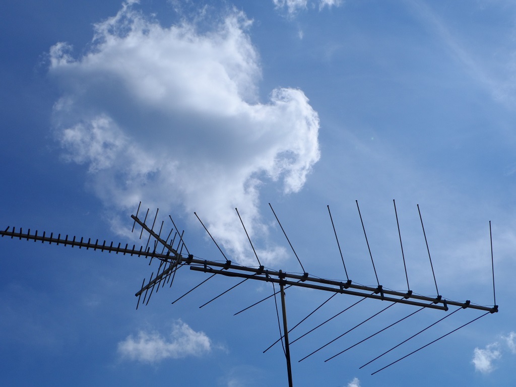

Can you tell us more about your 1980's large directional antenna, or maybe show us a photo? It might not have enough gain for Fox. Do you have a rotator?

Thanks for the photo. It looks like it should have enough gain for VHF and UHF in spite of the fact that one element is missing. You might have a bad connection at the antenna, a bad balun or bad coax.

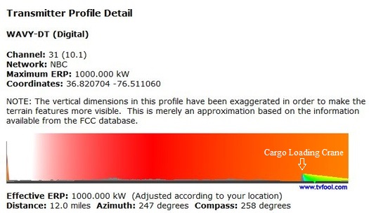

Yeah, you would think so, but I've seen it happen. I remember a case where both antennas were on the same tower, but one channel was giving a problem. It turned out that there was a large cargo loading crane in the signal path. One antenna was mounted higher than the other.

The signal barely makes it to your area:
If you look at the terrain profile, you will see why the signal has a hard time; attached to previous post.
I see a lot of trees in your area. See previous post for attachment. They can block signals. Do you have a clear path to Fox?
If this antenna checks out OK but you still have problems, you can replace it with a Winegard HD7698P.
