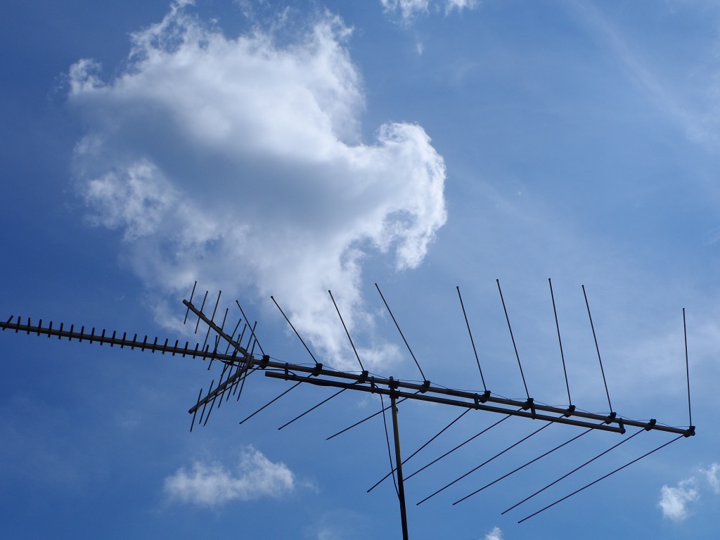

Can you tell us more about your 1980's large directional antenna, or maybe show us a photo? It might not have enough gain for Fox. Do you have a rotator?

1 Attachment(s)
I have a rotator. and I could believe that with the Fox in NY but the one in WB is on the same tower as everything else and they come in fine.
Attachment 1361
rabbit73 20-Jul-2015 9:49 PM
1 Attachment(s)
Thanks for the photo. It looks like it should have enough gain for VHF and UHF in spite of the fact that one element is missing. You might have a bad connection at the antenna, a bad balun or bad coax.

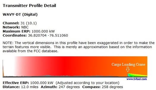

Yeah, you would think so, but I've seen it happen. I remember a case where both antennas were on the same tower, but one channel was giving a problem. It turned out that there was a large cargo loading crane in the signal path. One antenna was mounted higher than the other.

If you look at the terrain profile, you will see why the signal has a hard time; attached to previous post.
I see a lot of trees in your area. See previous post for attachment. They can block signals. Do you have a clear path to Fox?

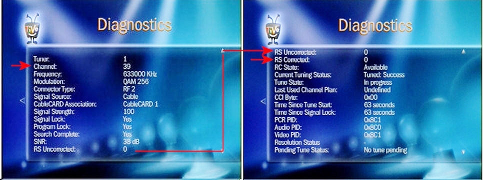

Does your Tivo Roamio Diagnostics Screen look like this?
http://forum.tvfool.com/attachment.p...1&d=1437529466
If yes, what it tells you about signal strength, SNR, and uncorrected errors will help you.
