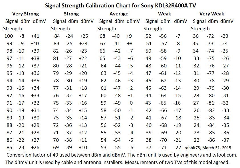

Even without a preamp the 7694 is a little better than the C2V on UHF, and a lot better on VHF, which you need. I'm not comparing mileage, I'm comparing performance.
You can add the antenna gain and the preamp gain to the NM figure in the report to improve it, but you must subtract the Noise Figure (NF) of the preamp because it adds its own noise that degrades the SNR (Signal to Noise Ratio) of your weak signals.
The C2V with a preamp would make a smaller package for indoors. The preamps to consider are the Antennas Direct Juice and the RCA TVPRAMP1R. The Juice is very tolerant of overload, but it doesn't have an FM filter. The RCA has an FM filter, is less expensive, but sometimes has quality control problems.
If you are trying for CH 6, some FM filters will mess it up, and some will protect it. See Attachment 2.

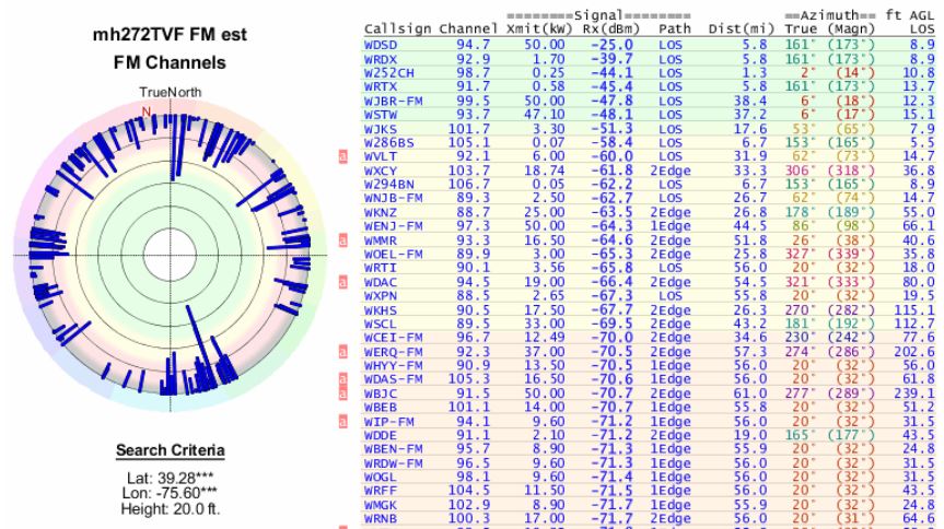

I investigated the possibility of second harmonic interference from an FM signal. The center frequency of channel 12 is 207 MHz, so there would need to be a strong FM signal around 103.5, but there isn't.
http://www.tvtechnology.com/digital-...ference/202503
It still might be fundamental overload from FM. Your strongest FM signal is WDSD with a signal strength of -25.0 dBm. You could test that theory by inserting one or two HLSJs in series before the preamp, using the high and common ports. The purists would say to put a 75 ohm termination cap on the unused low port.

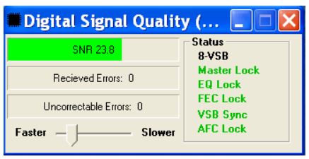

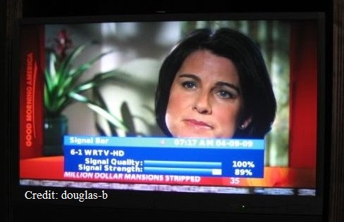

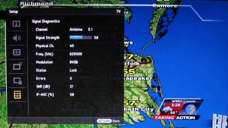

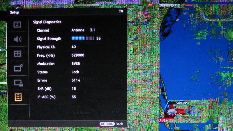

My Sony KDL22L5000 also gives a reading of SNR and errors of OTA 8VSB and cable clear QAM digital signals in the Diagnostics Screen. Here is a bad signal with picture freeze:
Good signal:
My Hauppauge 850 and 950 USB tuners can give a reading of SNR and errors, but the software isn't user-friendly for me.
http://www.hauppauge.com/site/suppor...l_monitor.html
Sometimes the aim of the antenna for maximum signal strength is not the best aim for maximum signal quality, as defined by SNR and errors. I first learned about this with an Apex DT502 converter box, that has dual signal bars, one for signal strength and one for signal quality (the inverse of errors).
I first aimed the antenna for maximum signal strength. Then, when I rotated the antenna slightly to the right, the signal strength was a little less, but there was a big increase in signal quality.
My point is, if you can find a way to measure signal quality, you can optimize the aim of your antenna.

Not to hijack this thread, but do you know of a shortcut to the Sony signal diagnostics, or do I always need to go through all 11 steps to get there, every time I switch channels?
Good question; it does take a lot of steps, and I haven't found a shortcut. Different models have it in slightly different places, and the information given by the screen has changed because each design team is able to do it the way they want.
My latest model is the KDL32R400A.
Home > up button > enter for Settings >up button twice for Setup > enter > up button for Product Support > enter >up button for Signal Diagnostics > enter
The screen gives readings for digital OTA 8VSB and for digital clear QAM cable, like this:
The latest version is my favorite because the signal strength range is much greater than the previous models that derived the strength readings from the IF AGC. The strength steps are about one dB each, which is very useful for antenna experiments.
I made a calibration chart giving dBm and dBmV values for the strength readings:
The signal strength range for the KDL22L5000 shown in post # 9 is much less. Once the reading gets to 79, which is about -4 dBmV (-53 dBm) it doesn't go any higher no matter how strong the signal. See Attachment 3.
