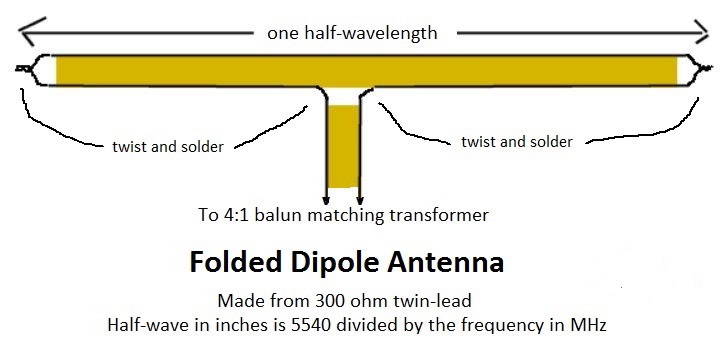

If you want to experiment with the C2V, you could add a preamp, a DIY folded dipole antenna for channel 6, a folded dipole for channel 2, and a HLSJ to combine a VHF-Low antenna with a VHF-High antenna.
http://www.hollandelectronics.com/ca...-Diplexers.pdf
http://forum.tvfool.com/attachment.p...1&d=1433096820
http://en.wikipedia.org/wiki/North_A...on_frequencies
Channel 2 is 54 to 60 MHz, center frequency is 57 MHz.
5540/57 = 97.2 inches dipole length.
Channel 6 is 82 to 88 MHz, center frequency 85 MHz.
5540/85 = 65.2 inches dipole length

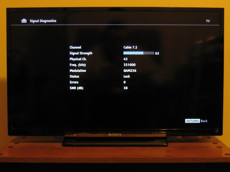

My Sony KDL22L5000 also gives a reading of SNR and errors of OTA 8VSB and cable clear QAM digital signals in the Diagnostics Screen. Here is a bad signal with picture freeze:
http://forum.tvfool.com/attachment.p...9&d=1433425884
Good signal:
http://forum.tvfool.com/attachment.p...0&d=1433425902

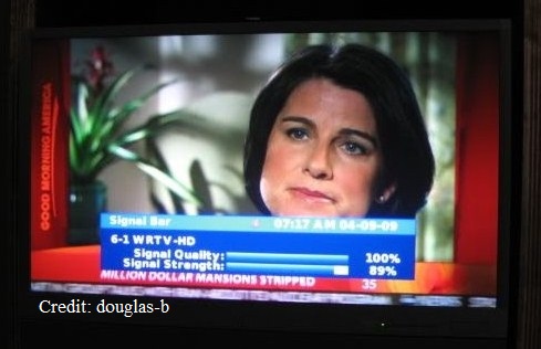

My Hauppauge 850 and 950 USB tuners can give a reading of SNR and errors, but the software isn't user-friendly for me.
http://www.hauppauge.com/site/suppor...l_monitor.html
http://forum.tvfool.com/attachment.p...1&d=1433418071
Sometimes the aim of the antenna for maximum signal strength is not the best aim for maximum signal quality, as defined by SNR and errors. I first learned about this with an Apex DT502 converter box, that has dual signal bars, one for signal strength and one for signal quality (the inverse of errors).
http://forum.tvfool.com/attachment.p...1&d=1433427681
I first aimed the antenna for maximum signal strength. Then, when I rotated the antenna slightly to the right, the signal strength was a little less, but there was a big increase in signal quality.
My point is, if you can find a way to measure signal quality, you can optimize the aim of your antenna.

Thanks rabbit, I have a Sony tv as well, and my signal strength screen looks like yours. It's not the ideal PBS channel, but it will have to do. I will try some of the things you suggested. One last question, how can you tell if the fm trap is working on the rca?
Thanks for all your help.

Good question; it does take a lot of steps, and I haven't found a shortcut. Different models have it in slightly different places, and the information given by the screen has changed because each design team is able to do it the way they want.
My latest model is the KDL32R400A.
Home > up button > enter for Settings >up button twice for Setup > enter > up button for Product Support > enter >up button for Signal Diagnostics > enter
The screen gives readings for digital OTA 8VSB and for digital clear QAM cable, like this:
http://forum.tvfool.com/attachment.p...1&d=1433438799
The latest version is my favorite because the signal strength range is much greater than the previous models that derived the strength readings from the IF AGC. The strength steps are about one dB each, which is very useful for antenna experiments.
I made a calibration chart giving dBm and dBmV values for the strength readings:
http://forum.tvfool.com/attachment.p...1&d=1433439345
The signal strength range for the KDL22L5000 shown in post # 9 is much less. Once the reading gets to 79, which is about -4 dBmV (-53 dBm) it doesn't go any higher no matter how strong the signal. See Attachment 3.
