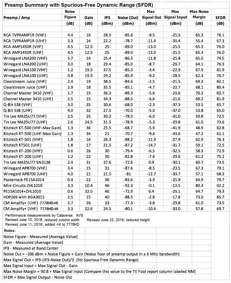

Measuring the noise figure of a preamp is not easily done; I don't have the proper equipment to do it accurately. It requires an expensive calibrated noise source. I depend upon the measurements done by Calaveras. The attachment is the result of his preamp measurements.
I can get a rough idea by monitoring the SNR of a weak signal. The preamp that gives the higher SNR of a weak signal should have the lowest NF.
You may have seen my posts about the pc-based Spectrum analyzer that Pete Higgins introduced to these groups. I'm wondering if I can use it to compare the LNA 200 to the KT 200?
A spectrum analyzer can be used to make an overload test by measuring IP3, Third order intercept point, which is what Calaveras does.
The way I make a preamp overload test is to increase the signal input to the preamp until the SNR of a weak signal starts to fall. This is the point when the IMD products from the stronger signals create spurious signals that raise the noise floor to reduce the SNR of the weak signal.
It doesn't surprise me that Winegard overstated the overload and noise figures. Isn't that the same company who came out with their 7 through 69 series of antennas right after we went to 51 channels? Sorry I couldn't resist that!
An antenna manufacturer isn't going redesign an antenna unless they can make a profit doing it.
When I bought my LNA 200 I wasn't a member of this forum yet, otherwise I probably wouldn't have purchased it. I had seen it on Amazon and Solid signal but my local electronics store had one on the shelf for a surprisingly lower price, I think I paid $30 for it. Impulse Buy!
It's an OK preamp, but it isn't as good as their marketing description says it is.
So, staying on topic, if the KT 200 has .4 DB of noise and LNA-200 is somewhere around 2 to 3 DB of noise, wouldn't that help a little?
A preamp with a lower NF should make a marginal weak signal a little more reliable. The tests by Calaveras say:
Kitztech KT-200 NF
VHF 0.6 dB
UHF 1.2 dB
Winegard LNA200 NF
VHF 5.7 dB
UHF 3.0 dB

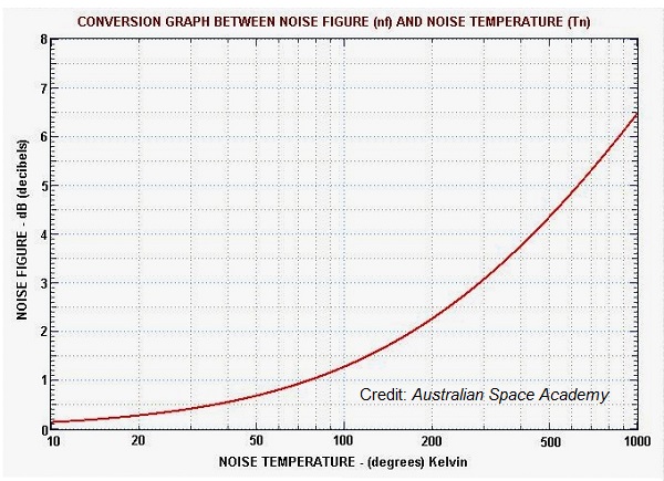

OK, I was able to read the Google cache. Extract here:
NOISE TEMPERATURE, NOISE FACTOR and NOISE FIGURE
Noise is ubiquitous in all communication systems. This noise may originate in the receiving system itself, and it is also present throughout the universe. It has a Gaussian or Normal distribution (bell-shaped curve), and can be characterised by a quantity we call the noise temperature Tn, which has the units of absolute temperature (Kelvin).
If the receiver is connected to an antenna that is pointed to the sky then the noise at the output of the receiver is a mixture of noise generated within the receiver itself and the sky noise collected by the antenna and transferred to the input of the receiver.
If the receiver is not connected to an antenna then the noise measured at the receiver output is only due to the noise generated in the receiver itself. This noise is usually referred to the receiver input and this input power is associated with a noise temperature that is called the receiver system temperature Tsys. This temperature is what sets the limiting sensitivity of the receiver. The lower this temperature the better the receiver.
A poor receiver may have a system noise temperature of several thousands of degrees Kelvin. A medium quality receiver may have a system temperature of several hundred Kelvin, and a good receiver a noise temperature below 100 K.
Note that if a communications receiver is pointed to a region of the sky near the galactic centre where the sky noise may be several thousand Kelvin, then there is no point in striving to have a receiver noise temperature below 100 K, because in this case the system noise temperature will be determined by the background sky noise, not the receiver noise.
ENGINEERING NOISE UNITS
Receiving systems that require a very low noise temperature often employ a low noise amplifier (LNA) that is placed very close to the antenna (to avoid cable losses). These amplifiers are characterised by two quantities: their noise performance and their overall gain. Often the internal noise is specified by a noise factor F or a noise figure nf. These are units used by engineers. However, there are simple formulae that relate F, nf and Tn.
The following graph allows easy conversion between noise figure and noise temperature.
SKY NOISE TEMPERATURE
Astronomical radio sources in the sky are a source of noise for receivers with antennae pointing skyward. It is often useful to know the value of the effective sky temperature and how it varies with frequency. The graph below left shows the effective sky temperature for a wide beamwidth antenna.
By far the greatest noise generator in the sky lies at the center of the milky way, and if this lies in the beam of the antenna the noise temperature will be greater than when the galactic center and most of the galactic plane lies below the horizon. The two lines at the extremes of the hatched region indicate the minimum and maximum noise temperatures to be expected for these two extreme conditions. The actual noise temperature experienced will thus lie in the hatched region between these two conditions.
END Extract
Thank you.
File Type: jpg Noise Figure vs Noise Temperature_1.jpg (129.5 KB, 10179 views)
File Type: jpg Sky Noise Temperature vs Freq MHz_1.jpg (87.4 KB, 10120 views)

Measuring the noise figure of a preamp is not easily done; I don't have the proper equipment .I depend upon the measurements done by Calaveras. The attachment is the result of his preamp measurements.
(LNA200)
Kitztech KT-200 NF
VHF 0.6 dB
UHF 1.2 dB
Winegard LNA200 NF
VHF 5.7 dB
UHF 3.0 dB
Well, that's quite a big difference (in noise) between those two amps, I might buy the KT 200 just to experiment with.
I do have some issues pulling in some stations. I have to establish a baseline though because I'm looking at these different signal meters at random. I like the signal meter on my Toshiba TVs . They have a couple of different types of information including a graph.
I don't like the signal meter on the Channel Master or the Homeworx tuners. They use signal quality which may or may not be accurate. They use the same software.
At any rate, as you say, if I have a marginal signal that low noise Kitz preamp could help.

Tower guy and Rabbit, thanks!
Tower Guy and Rabbit,
Thanks for the article and explanation about noise and noise in the universe. I'm kind of a space buff,I like to watch My Science Channel other channels, one of my favorite shows is "The Universe".
On one particular show about the Big Bang, they were talking about leftover energy after the big bang.They actually used the static seen on an old analog TV set when there is no signal. As an example they showed the TV screen with that random static said that was energy / noise left over from the Big Bang it's all around us.
Anyhow, the article made for some good reading. I'll probably have to read it and several more times to even get a grasp on it.
