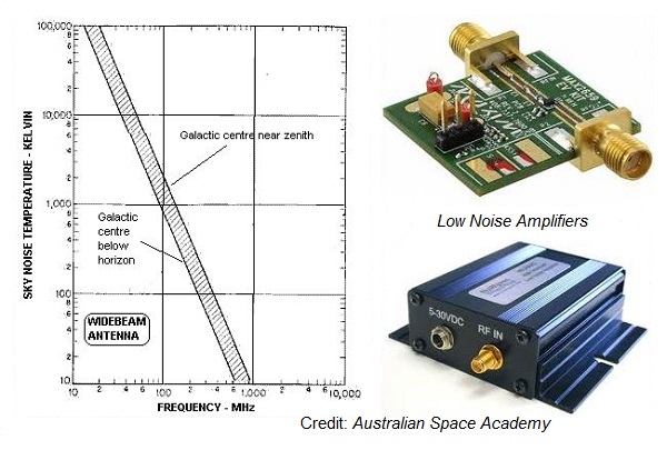

Tower Guy 13-Apr-2019 6:05 PM
An extremely low nose figure in a preamp, such as the Kitztech, has very little effect on TV reception. This is because the antenna is aimed at the horizon. Only when an antenna is aimed up at a satellite or celestial body will a noise figure less than 3 dB offer much improvement.
The exception is that a lower nose preamp can be located further from the antenna, after some feed line loss, or after a band pass filter, and still offer an advantage.
https://www.spaceacademy.net.au/spacelink/noise.htm
rabbit73 13-Apr-2019 6:08 PM
2 Attachment(s)
Norton blocked that link for me; said it was dangerous......might have been interesting.
OK, I was able to read the Google cache. Extract here:
NOISE TEMPERATURE, NOISE FACTOR and NOISE FIGURE
Noise is ubiquitous in all communication systems. This noise may originate in the receiving system itself, and it is also present throughout the universe. It has a Gaussian or Normal distribution (bell-shaped curve), and can be characterised by a quantity we call the noise temperature Tn, which has the units of absolute temperature (Kelvin).
If the receiver is connected to an antenna that is pointed to the sky then the noise at the output of the receiver is a mixture of noise generated within the receiver itself and the sky noise collected by the antenna and transferred to the input of the receiver.
If the receiver is not connected to an antenna then the noise measured at the receiver output is only due to the noise generated in the receiver itself. This noise is usually referred to the receiver input and this input power is associated with a noise temperature that is called the receiver system temperature Tsys. This temperature is what sets the limiting sensitivity of the receiver. The lower this temperature the better the receiver.
A poor receiver may have a system noise temperature of several thousands of degrees Kelvin. A medium quality receiver may have a system temperature of several hundred Kelvin, and a good receiver a noise temperature below 100 K.
Note that if a communications receiver is pointed to a region of the sky near the galactic centre where the sky noise may be several thousand Kelvin, then there is no point in striving to have a receiver noise temperature below 100 K, because in this case the system noise temperature will be determined by the background sky noise, not the receiver noise.
ENGINEERING NOISE UNITS
Receiving systems that require a very low noise temperature often employ a low noise amplifier (LNA) that is placed very close to the antenna (to avoid cable losses). These amplifiers are characterised by two quantities: their noise performance and their overall gain. Often the internal noise is specified by a noise factor F or a noise figure nf. These are units used by engineers. However, there are simple formulae that relate F, nf and Tn.
The following graph allows easy conversion between noise figure and noise temperature.
https://forum.tvfool.com/attachment....8&d=1555184738
SKY NOISE TEMPERATURE
Astronomical radio sources in the sky are a source of noise for receivers with antennae pointing skyward. It is often useful to know the value of the effective sky temperature and how it varies with frequency. The graph below left shows the effective sky temperature for a wide beamwidth antenna.
By far the greatest noise generator in the sky lies at the center of the milky way, and if this lies in the beam of the antenna the noise temperature will be greater than when the galactic center and most of the galactic plane lies below the horizon. The two lines at the extremes of the hatched region indicate the minimum and maximum noise temperatures to be expected for these two extreme conditions. The actual noise temperature experienced will thus lie in the hatched region between these two conditions.
https://forum.tvfool.com/attachment....9&d=1555186399
END Extract
Thank you.
