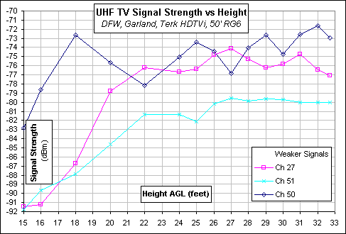

UHF Signal Strength vs Antenna Height (AGL)
This post is a continuation of:
In the previous post linked above; the signal strength of 27 DTV channels was measured as a small antenna (Terk HDTVi) was raised in height.
The signal strength of the individual 27 measured DFW stations varied considerably, from ~-35dBm to about -90 dBm. Due to the wide range of strength, it might not be very instructive to plot all signals on the same graph.
The following graph shows three of the weaker signals strength plotted versus antenna height.
This graph illustrates what can be seen throughout all the measured signals (strong and weak).
That is:
1. Some channels show maxima and minima in signal strength as antenna elevation is changed.
2. The general trend is increasing signal strength with increases in antenna height.
Channel 50 shows the most distinct pattern of maxima and minima. This is evidence of signal layering; the constructive and destructive summation of two or more wavefronts.
Channel 51, although close in frequency, shows increasing signal strength with small perturbations. The two stations (channels 50 and 51), yield different responses at the receiving antenna, this could be related to differences in path geometry.
The transmitting antennas of these two stations are located on different towers and at different tower heights*. Incidentally, both are low power=15kW.
*Such transmitter/antenna info can be found at the FCC site, or more conveniently at Rabbitears.info.
Channel frequency does matter. The signal wavelength is inversely related to frequency and constructive/destructive combinations are a matter of signal phase (which is wavelength related). Signal strength differences at the receiving antenna are a result of the combination of frequency and path geometry.
In a different environment, it is likely that the above trends continue, but a specific frequency (channel) may or may not respond with observable maxima and minima.
The response of channel 27 is somewhat typical of the measured channels (total number=27).

tripelo,
As always, very interesting information. I am guessing that the channel I lost by moving my UHF antenna up to 40’ is a phenomena similar to your channel 50 between 18’ & 22’. The ~ 6 dB weaker signal probably didn’t stop demodulation at your location but with my already weak 1 & 2 edge signals 6 dB is a real killer.
You are much better equipped to perform meaningful analysis with your Sencore SLM 1456 than I am using my software defined radios. My SDR’s have ~50 dB dynamic range and I believe the Sencore has ~114 dB (-98 to +16 dBm) range. It also appears to support direct readout in dBm and all I can do is compare relative signal strength differences in dB. But then I expect your Sencore cost you slightly more than the $8 to $9 that each of my SDR tuners cost me. These little devils plug into a USB port on a computer and tune from 24 MHz to 1.7+ GHz with good sensitivity. In addition to their limited Spectrum Analyzer capabilities I use a free program called SDR Sharp, under XP & Windows 7, to listen to commercial FM, tune the Ham bands (including all the local repeaters), VHF & UHF air and NOAA weather broadcasts. I even downloaded a plugin that allows me to start them scanning and stops on an active channel. I posted some information about them here:

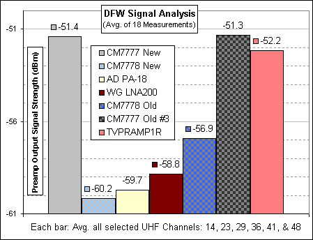

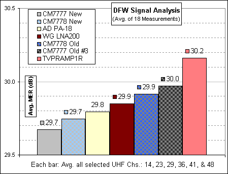

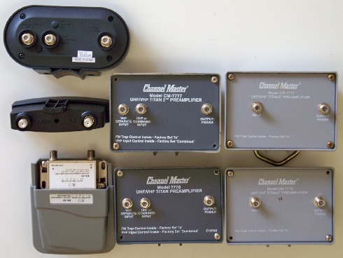

Compare Several Preamplifiers OTA-DFW
Signal measurements from several preamplifiers were compared, while receiving selected UHF channels and one VHF channel in the Dallas Fort Worth area.
Preamps Compared (shown in image below):
- Channel Master 7777 (new version)
- Channel Master 7778 (new version)
- Channel Master 7777 (old version)
- Channel Master 7778 (old version)
- RCA TVPRAMP1R
- Winegard LNA-200
- Antennas Direct PA-18
All 7 preamps performed overall within ~0.5 dB of each other when comparing the measured MER* (modulation error ratio). The RCA TVPRAMP1R showed best UHF MER performance at 30.2 dB. MER is essentially the post-detection S/N ratio in dB. (MER performance graph below)
As expected, there was considerable difference in UHF output signal strength (approximately 9 dB variation). Both the CM7777 versions (old and new) had highest UHF output signal strength. (Output signal strength graph below)
Note: Previous measurements, made a day earlier, with these preamplifiers indicate that the results are somewhat repeatable. As the data in the graphs indicate, the precision of measurements can be made to within 0.1 dB, but mainly due to the propagation path, the accuracy is somewhat less. The rank order of the preamp’s measured performance was unchanged from one day to next.
*Modulation Error Ratio (MER)
Measured MER can be a good relative indicator of the overall system noise figure. Within limits, a system with a lower noise figure will have a higher MER. There is nearly 1:1 correspondence between noise figure and MER; a 1dB improvement in noise figure will provide about 1dB improvement in MER.
Other factors affect system MER, for example if two preamps had the same noise figure and one had higher gain, then likely the system MER would be highest for the preamp with highest gain. With typical preamps and system losses, there could be about 0.1 dB MER increase for about 1-2 dB of additional gain.
More to be posted, some tomorrow:
- Test Procedure & Configuration
- MER Performance per Channel
- Signal Output Level per Channel
- VHF Channel 8 Performance (MER & Signal Strength)
- Other Preamps
File Type: gif Compare Preamps Output Sig. Strength_DFW.gif (9.3 KB, 9479 views)

Old 24-Jan-2015, 3:20 PM   #88
Since all the MER readings were with 0.5 dB, it's pretty much a statistical dead heat. No one would ever notice any difference under typical customer reception conditions. If you use a wider scale on your bar graph say from 15 to 35, you'd have a very gradually sloped line, almost flat, around the 30 dB line.

tripelo,
Based on manufactures specs. & cost my mind tells me that my $70.00 LNA-200 should perform better than my $23.00 RCA’s but when I swap them back & forth I can’t tell any difference (signal strength & SNR). The one difference I’ve repeatedly noticed is that the RCA’s seem more immune to overload from my strong FM & TV stations when the array is pointed at them.
I’ve only found two amplifier designs that don’t show this overload issue, the RCA’s and my various PCT drop amplifiers (MA-B1015-1A, PCT-MA2-4P & PCT MA2-M). The drop amps don’t have as much gain but my SNR’s hardly change when I trade between the RCA’s & the PCT’s.
It would be really interesting to compare the dynamic ranges & strong signal handling characteristics of the various offerings.
As always, great work!
Old 25-Jan-2015, 3:07 PM   #90
tripelo
Location: Dallas, TX
Posts: 173
Thank you ADtech and Pete. Your comments are appreciated.
Since all the MER readings were with 0.5 dB, it's pretty much a statistical dead heat…
That is a possibility.
…No one would ever notice any difference under typical customer reception conditions…
Most would probably agree.
…If you use a wider scale on your bar graph say from 15 to 35, you'd have a very gradually sloped line, almost flat, around the 30 dB line.
Yes
Originally Posted by Pete Higgins View Post
...found two amplifier designs that don’t show this overload issue, the RCA’s and my various PCT drop amplifiers (MA-B1015-1A, PCT-MA2-4P & PCT MA2-M)...
Interesting experience with preamps and drop amplifiers.
As both you and ADtech seem to understand and appreciate, in many cases, the dynamic range of a preamp is a strong factor contributing to overall satisfactory performance.
…interesting to compare the dynamic ranges & strong signal handling characteristics of the various offerings…
Yes

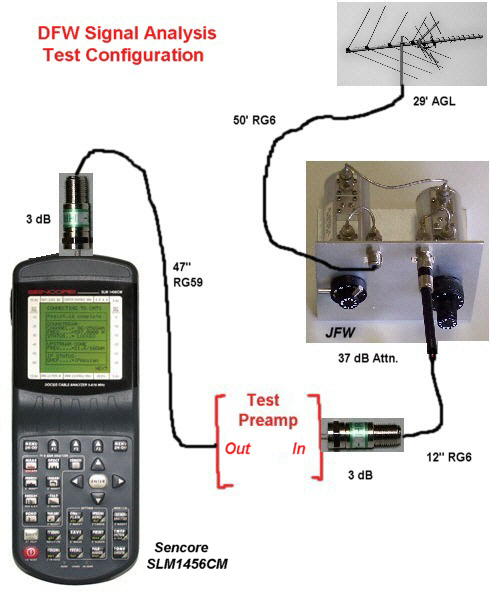

Compare Preamplifiers - Test Procedure & Configuration
Referring to Preamp Comparison data posted earlier.
Comparison method; signals and path from antenna to measurement receiver:
1. Received on Radio Shack all-band antenna (similar to VU-90) at approximately 29 feet AGL, thru 50 feet commercial grade RG-6 cable
2. Attenuated by 40 dB; two JFW serial step-attenuators total 37 dB followed by 12” RG6, then one Holland 3 dB FAM attenuator.
3. Amplified by preamp-under-test with its power inserter and power supply
(If available, preamp FM trap set to ‘In’, If dual inputs, set to ‘Combined’)
4. Attenuated 3 dB; Output thru 4” RG-59 and Holland 3dB FAM attenuator
5. Received from preamp and 3dB attenuation, measured on Sencore SLM1456CM
Image depicting Test configuration shown below:
The Sencore 1456CM executed a channel scan program wherein Modulation Error Ratio (MER) and Signal Level were measured and recorded while receiving DFW stations. Each test consisted of SML1456CM channel scan that measured signal MER and Strength for each of the following channels: 8, 9, 14, 23, 29, 36, 41, and 48. The scan was repeated three times (total three scan test time ~ 5 minutes). Then, the next preamplifier was tested, and sequence repeated until all 7 preamps had been examined.
Channel 9 data not planned to be included in the posted data. This is mainly because channel 9 is weaker than channel 8, to reliably receive it with all preamps would have required input attenuator adjustment during the tests.
The time from beginning-to-end for the complete test operation was about 75 minutes. This total time included, as a data integrity check, some replication of the first two scans at the end. Also included some other tests not reported.
The test data was downloaded from the Sencore 1456CM to a desktop computer for analysis and formatting.

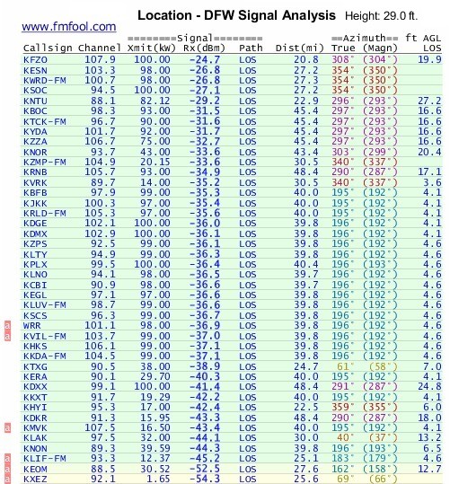

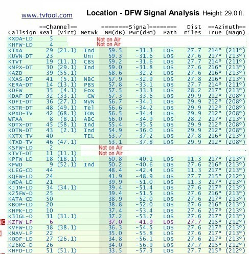

The distance to the stations is ~28-30 miles, the path line-of-sight. Prior and post measurements indicated the signals were relatively steady during the test time. A clear stable-weather day was chosen to perform the tests. The signals are strong at this location, thus the need for 40 dB attenuation prior to the preamps. The objective was to lower signal strength such that the stations had only moderate S/N ratios within measurement range. (High signal strength can cause maximum S/N indication (max MER=36 dB) on the SLM1456CM.
The RF environment in DFW consists of dense signals. Virtually every usable UHF channel is occupied, only 2 VHF stations (Channels 8 & 9). The FM band has nearly every available channel occupied (many with full-power). Other strong signals include NOAA weather radio ~ 4 miles away.
The Radio Shack antenna responds to most of the above listed signals.
The test setup somewhat emulates conventional TV reception. The 40 dB of attenuation to preamp input reduces all signals, including FM and other potential interference sources. This reduction in signal strength could correspond to fringe area reception. The receiver is represented by the SLM1456CM and a transmission line loss between preamp and receiver being represented by a 3dB attenuator (similar to ~50’ RG-6 at UHF).
Reference charts below: TVfool & FMfool charts for the preamp compare test location.

I’d be really pleased if I had your signal environment. My strongest signal of interest is ABC, channel 7 @-87.0 & 2-edge to boot. Box Springs Mtn. 3.5 miles out my back door and in-line with my LA stations is home to numerous communication towers, a channel 26 PBS TV station, several FM broadcast stations, a 2-Meter repeater that just booms in on my TV antennas plus I also pickup four NOAA weather channels with my LA array.

Pete, thank you for your comments.
…I’d be really pleased if I had your signal environment…
Your signal situation does seem particularly tough.
Guess most people have a more difficult TVfool chart than this one in DFW.
This DFW location is good for UHF test purposes.

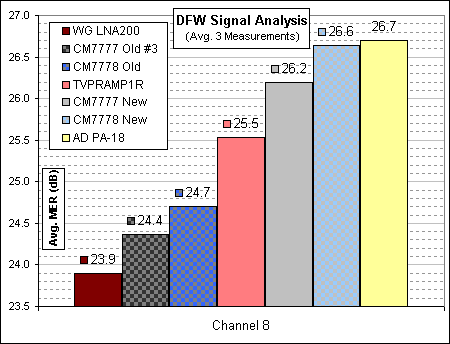

Compare Several Preamplifiers (cont.)
Referring to previous posts:
- Compare Several Preamplifiers OTA-DFW
- Compare Preamplifiers - Test Procedure & Configuration
As mentioned earlier, the two VHF channels in the DFW area are channels 8 and 9. Measurements of both channels were attempted during the channel scans. Because channel 9 signal strength is weaker than other channels in the scanned list, it could not be reliably decoded by some of the preamps without attenuator adjustment during the tests.
Below is a graph showing the averaged MER value for each of the 7 preamplifiers receiving channel 8. The values shown represent the average of 3 individual measurements. The range of MER for the preamps is nearly 3 dB. The AD PA-18 provided the highest MER (26.7 dB), with the new CM7778 second (26.6 dB).
The image below shows the output power level for each of the preamplifiers.
The highest output power is shown for the CM7777 versions:
- CM 7777 new (-54.6 dBm) and,
- CM 7777 old (-57.7 dBm)
Notably, the lower MER values for channel 8 originated in the preamplifiers with separate amplifier sections for VHF and UHF.
- TVPRAMP1R
- CM7778 old
- CM7777 old
- WG LNA200*
*The WG LNA-200 has separate amplifiers even though it doesn’t have dual inputs.
A plausible explanation for lower channel 8 MER values could be;
The VHF-only sections have higher noise figures & generally lower gain than the VHF-UHF combination or UHF-only sections (single or dual amplifier versions). Investigations into the hardware design tend support this. Some factors specific to VHF could make this design choice seem logical to a manufacturer.

Test Location:
Garland, TX, ~30 miles line-of-sight to 27 DFW stations, located within +/-3 degrees azimuth.
Test location TVfool info posted earlier:

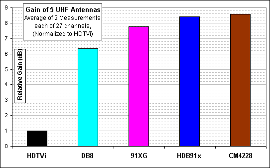

Received Signal Strength Data Analysis
(continued from previous post)
Part 3. Received Signal Strength Data Analysis, Five UHF Antennas
Attached are four Graphs depicting a summary of data analysis.

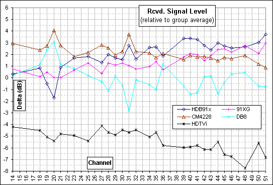

1. Average Relative Gain, (Image below):
An average 2 scans of all channels for each antenna, relative to the HDTVi antenna.
2.Average Relative Gain per Channel (image below)
A two-scan average of all antennas except HDTVi relative to HDTVi
(included four scans, two at beginning and two at end).
3. Average SWR 5 Antennas (image below)
SWR was derived from measured S11 (Return Loss). The curves represent the
smoothed scan averages for each antenna.
4. Mismatch Loss vs. SWR* (image below, see Note at end)
Table showing mismatch loss as a function of SWR.
========== Comments ====================
The CM4228 had overall slightly higher signal levels, this was mainly due to better gain at lower channels.
The HDB91x delivered highest signal strength at mid and higher channels, and with exception at channel 20, 2nd highest at lower channels.
The 91xg pretty much tied with the HDB91x at very highest channels, with average levels at lower channels.
The DB8 was about average at lower channels similar to the two Yagis. At midband signal levels dropped and stayed lower thru upper band. The signal level loss at midband might be related to the SWR (approaching SWR=4, with nearly 2 dB mismatch loss).
