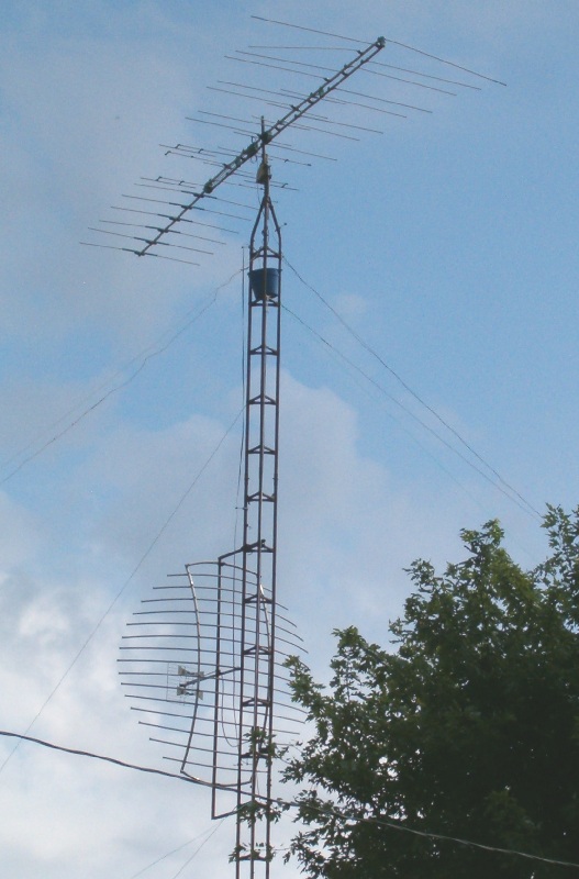

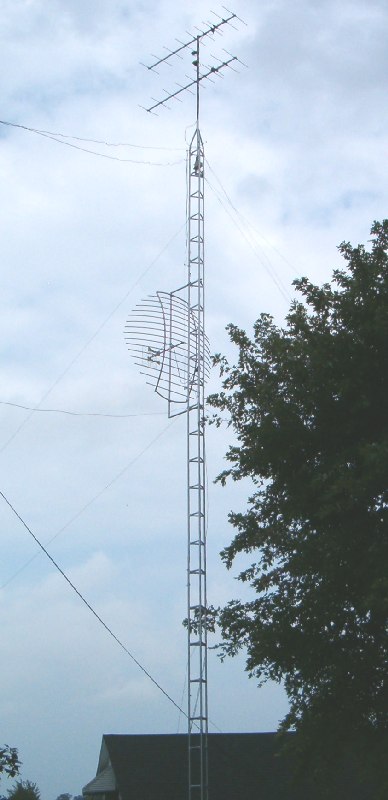

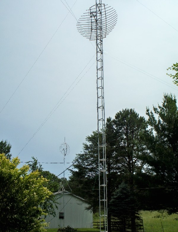

Tests were conducted in 2011 to evaluate performance of some TV antennas.
The tests involved a signal source feeding a CM-4228 at ~45 ft AGL radiating to antenna under test located ~150 feet distant at ~level height to source antenna.
The signal source was a homebrew signal synthesizer, remotely controlled at the receiving location by a notebook PC.
Received signals from the test antenna were measured using a homebrew wideband power meter with digital readout and logged into an Excel spreadsheet.
The test frequencies were chosen to represent channels that might be of personal interest.
This location is rural, the only UHF strong signal is at Channel 14; the frequency band was omitted from the tests.

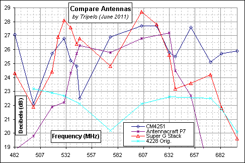

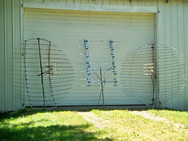

The last image below shows results from comparing four antennas:
- Channel Master 4228 (the most common of the older versions)
- Channel Master 4251
- Antennacraft P7
- Antennacraft SuperG 1483 (the stacked Hooverman version)
The decibel scale is relative for a comparison between the units.
Caveats:
Each antenna was installed at the test mast for a few days while several preamps were individually tested with that particular antenna. So, each antenna was measured days apart from others.
There may be some SWR effects in the antenna gain patterns, affecting each antenna differently.
Comments:
In general, testing against distant weak TV signals was consistent with the measured results. CM-4251 was best on upper UHF. P7 performed well on mid UHF channels. SuperG 1483 was comparably good on mid-20 range channels.

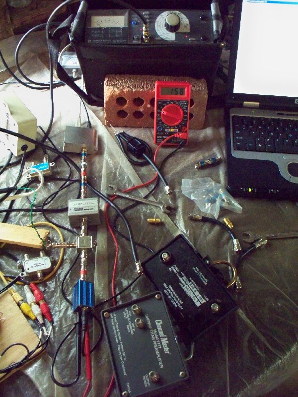

Below is an image taken in 2011 around the time of the preceding test. The workbench is behind that window, inside the building next to the receiving antenna mast.
Shown on part of the workbench, among cables, planks, and bricks; from top to bottom, left to right:
- Some version of Research Communication preamp (loose)
- Blonder Tongue FSM-11 signal strength meter with brick
- Antennacraft preamp power supply (loose)
- Signal synthesizer (in aluminum case)
- Half Wave Loop balun
- DMM (Red)
- HP notebook computer
- Holland Splitter
- Various fixed attenuators (in-line)
- Another Research Communications preamp (in-line)
- Power Inserter (in-line)
- Winegard Power Inserter (loose)
- Fixed attenuator (Red, in-line)
- Wideband power detector (blue aluminum case)
- Some version Winegard preamp
- Channel Master preamp (loose)

The near tower has the transmitting CM-4228. Hard to see, it is mounted directly behind the CM-4251. The tower and that particular CM4251 have stood for more than 40 years.

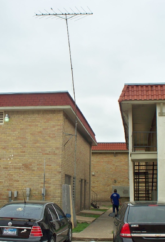

No intention to divert from other antennas and tests, or other related.
Took down an antenna this morning and thought it (or the story) may be interesting to someone.
It's a Log-V antenna, VHF (low and high), maybe FM.
It was located at an apartment complex and appeared to be a potential hazard to those who lived there. From the ground, the antenna looked to be in good shape (see photo). Realizing that the antenna might soon be lost to wind, an inquiry was made and the responsible people were glad to have it removed.
The antenna originally had four guy wires that had long since broken. The guy wire remnants were so degraded that flexing a couple of times, they crumbled.
Turned out, the antenna is in good shape. Whoever designed and built it, made it to last. Element-to-boom support is very sturdy. All the elements folded back to the boom perfectly, no insulator was cracked. On the ground, the gold anodizing is still visible.
The antenna could be vintage mid-1960s. Certain features in the construction point to early times. Mid 60's is about the earliest date that Log-V antennas were available, and was probably about the time the apartment complex was constructed. Could be a Radio Shack antenna. Seems that during the 60s, Radio Shack marketed several major brands; Finco, Channel Master, JFD, and others.
If anyone has clues to it's origin, please post.

Tower & CM-1110
Pete, have been out of town for a while. Was actually in KY at the main antenna test location, and climbed above the top of the tower a few times. Above the top, to be explained later.
Please, feel free to update on your antenna work.
In the meantime, this is an image taken in 2009 of the main tower (lower part shown in Post #1) as it has stood since I personally erected/installed in the early 1970's. The tower and antennas were largely ignored all those years, (meaning almost no maintenance), although they reliably provided TV reception for my parents.
The large VHF antenna is a Channel Master Quantum CM-1110.
The plastic bucket lodged in the tower was there temporarily for convenience to hold tools and such. The photo was taken just before the CM-1100 was lowered to the ground.
Since that time in 2009, there have been several different antennas residing above the tower top, or near the top of the tower. Maybe later can show some of the other antenna arrangements.

This is a photo of the antennas that replaced the CM-1110.
The only objective of the VHF antennas was to better receive WKYT (at that time RF channel 13), 74 miles distant, 2-edge diffraction according to TVfool.
The configuration:
- Two Winegard YA-1713, stacked
- Combiner; Winegard CC-7870
- Spacing; 43 inches (was varied +/- 18 inches while watching Signal Meter)
- Mast length; 10.5 feet, ~ 7.5 feet above tower.
(Made from heavy duty top fence rail (SS-20, ~1 & 3/8 inch outer diameter)
- Channel Master antenna rotator moved inside tower for stability.
- Final Preamp, Channel Master CM-7777 (original), a WG-3700 was tested
- All cables RG-6, custom installed connectors.
In 2010, WKYT changed RF channels from VHF 13 to UHF 36, so the YA-1713s were not of much use after that.
The configuration stayed in place for approximately a year, until ~mid 2010.

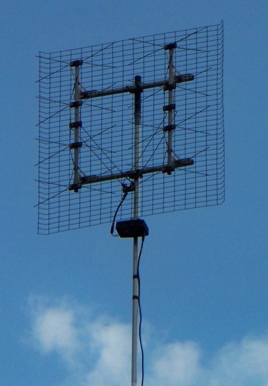

The following image shows an 8-bay antenna that was purchased in 1970. Pretty sure it is Channel Master, probably a precedent to the popular ’original’ CM-4228. The physical dimensions and construction are different. Note the differing transmission line feeding the right and left 4-bays, it extends downward. The antenna demonstrated about 0.5 dB better gain on low to mid UHF channels than the popular ‘original’ CM-4228. No comparison was made for upper channels.
That antenna was hit by a tornado in 1971, breaking a whisker (upper right). The tornado destroyed surrounding buildings, along with the tower and other antennas on it.
Note: People lost their lives and many homes were destroyed in that tornado.
The 8-bay whisker was repaired and it was placed in storage until 2010.
Mid 2010, the antenna was installed to receive channel 22 WCTE at 65 miles distant. At that time WCTE was transmitting 57 kW ERP. TVfool showed the path diffraction as 2edge.
For convenience and shorter preamp feed length, the 8-bay was mounted upside down.
The preamp was the UHF section of the CM-7777 (VHF portion in use for Yagis), using an 'inside' balun (with silicone waterproofing).
The Yagis and the CM-4251 already had their separate cables and were combined with UVSJ behind the TV. So, behind the TV, the 8-bay channel 22 signal was separated from CM-7777 coax with another UVSJ, then added back to CM-4251 UHF signals via a Channel Master Jointenna.
Although the reception was very good for WCTE, channel 22, this antenna configuration lasted only a few months.
