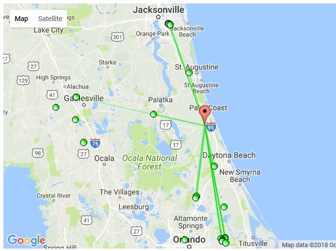

Add 2nd antenna or a rotor?
I have a DB8e on a mast - elevated 7 feet above lower roof line - clear line of sight, I have a Juice Amp I point mostly to the Orlando towers.
I get most of the channels I want with the exception of CBS and NBC, these are either great (when they come in) or nothing at all. My question is should I use an antenna rotor to change direction when I want to get to CBS and NBC, since my other channels are just fine currently. I was warned in an earlier post that adding a second antenna can be tricky with signal interference, so I am not sure which way to go.
I appreciate any advice, and specific product recommendations (rotor,antenna)
My analysis: http://www.tvfool.com/?option=com_wr...9038a14234f9fd

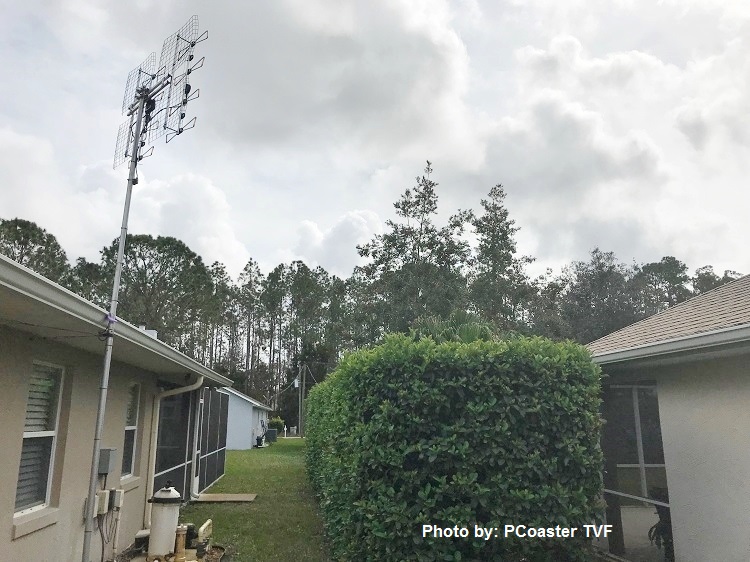

Pic Here https://drive.google.com/open?id=132...9y9K2_K7LhMKYT
4. Re: CBS. If you have the DB8e's panels in the basic parallel configuration and if the DB8e is aimed directly at Bithlo but WKMG won't come but, if the antenna is aimed elsewhere (which direction?) and comes in, then you likely have a signal path blockage (usually trees or buildings out in front of the antenna) and you need to consider moving the antenna, if feasible, to get the antenna out from behind the obstacle. Even if there is no visible obstruction, you may still need to relocate the DB8e and try again as you may have found a near-dead spot by accident. Just don't drill any new holes yet...
Answer: I uploaded a pic of the antenna, also the compass settings (rough idea using iPhone compass). I have the antenna mast cemented in so no relocating, but willing to add a rotor, adjust as needed,
etc.
Pic Here:
https://drive.google.com/open?id=1lh...tjKuEC70-bPVrd
Thanks for your time and advice!

Old 9-Feb-2018, 7:00 PM   #4
You'd probably get the most cost-effective results if you were to add at least 5' to your mast so the antenna cleanly misses your neighbor's rooftop with a couple of feet to spare. As it is now, that roof is probably in your Fresnel zone and is effectively blocking too much of your RF signal path which then requires you to have to mis-aim the antenna to pick up a signal from off-axis.
I have little confidence in smartphone apps for use as a compass. I usually joke that they're accurate to only +/- 180°. It's far more practical to use the interactive maps feature here, turn on the signal path lines, and then drag and drop the marker onto the antenna mounting location in the satellite (not the 3D view, if it pops up when you zoom in)view. The greenlines give you a clear visual reference as to where the signal path lies.
Your indicated signal path to Bithlo is 170° true, to the WESH translator is 187° true. You're mis-aimed by up to 30-40° at 150° which suggests that either you may have one of the sidelobes instead of the primary reception lobe of the antenna facing south or, as mentioned above, the signal is getting blocked by the neighbor's roof. At over 60 miles out, there is no margin for errors or omissions, you have to do everything right.

Old 9-Feb-2018, 10:56 PM   #10
do you think a different antenna would help along with the higher mast?
You already have the best antenna for 18.
I just got deep into the settings and see that my NBC Channel 2.1 is actually Channel 18 with a SNR of 0-12 DB and a modulation of 8 VSB.
Good work. The important number is the SNR; it must be more than 15 dB for reception. Your DB8e antenna is designed to receive real channel 18, which is listed as strong on your report.
My guess is that something is blocking the signals on their way to your antenna, like trees or a roof (as ADTech said).
Another possibility is electrical interference, perhaps from a solar power system inverter.
Is you coax grounded with a grounding block connected to your house electrical system ground?

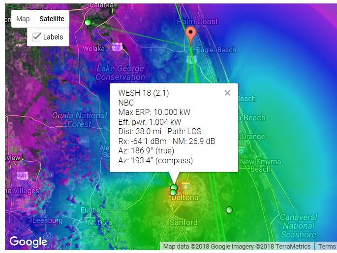

I would like to look at the satellite view of your location. Would it be possible for you to give me your address and coordinates of your antenna in a PM?
Old 11-Feb-2018, 1:24 AM   #11
Thank you for the additional information about your location. I looked at the satellite view and WESH 18 does seem to clear your neighbor's roof, but there are trees beyond his house that look like they are in the signal path. Trees block TV signals:
scroll down to Trees and UHF

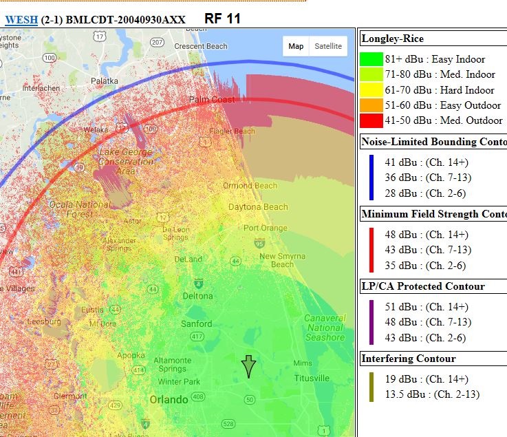

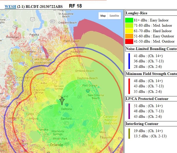

WESH has three transmitters:
https://rabbitears.info//market.php?...&callsign=WESH
The WESH transmitter on RF channel 18 is considered a DRT (Digital Replacement Translator) that is running only 10 kW, which is not a lot of power for UHF.
https://rabbitears.info/tvq.php?requ...ms&facid=25738
But, it has a very directional antenna that sends only 1 kW ERP in your direction:
http://www.tvfool.com/?option=com_wr...dALLTV%26n%3d3
I think the TVFool report is a little too optimistic about WESH on RF 18. The FCC Longley-Rice coverage map shows your location outside the red contour for WESH 18 because of its low power and directional antenna that favors the SE:
Link to that map:
https://rabbitears.info/contour.php?...a&site=2&map=Y
The coverage map for WESH 11 shows your location inside the contour:
Link to that map:
https://rabbitears.info/contour.php?...a&site=1&map=Y
If raising and/or moving the antenna doesn't help with WESH, I suggest you add a VHF-High antenna to your DB8e to try for WESH on RF 11. The VHF antenna can be combined with the DB8e using a UVSJ UHF/VHF combiner with no interference.

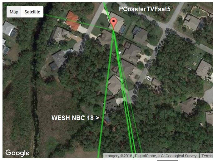

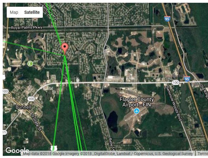

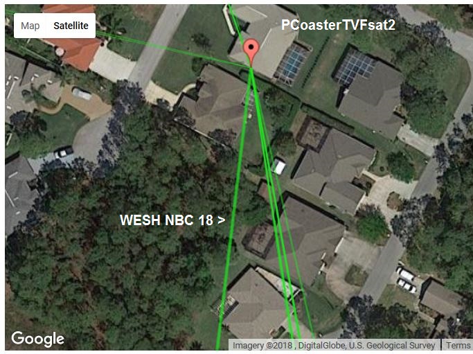

Old 13-Feb-2018, 2:26 AM   #14
Thank you for your permission. It doesn't look like your neighbor's roof blocks the signals, but the trees might affect both directions from the south:
