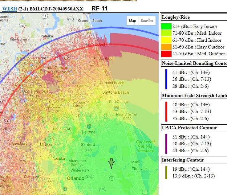

The coverage map for WESH 11 shows your location inside the contour:
http://forum.tvfool.com/attachment.p...1&d=1518313234
Link to that map:
https://rabbitears.info/contour.php?...a&site=1&map=Y
