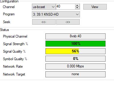

You're signal at 100% but quality is only 56%.
This tells me to look at noise and/or overload. You're getting plenty of signal, just a crappy one. Or the tuner doesn't know what to do with it.
I couldn't use the CM7777 due to overloading, I went with a Wineguard PA100, (not sure of the exact model I'm at work and can't look it up now), it has an adjustable gain and I could dial it up to overload then back down to just under overload. Solved the issue I had well.

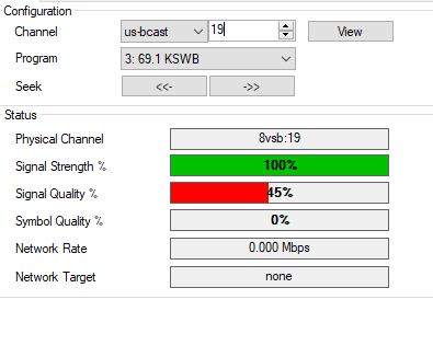

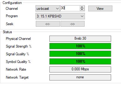

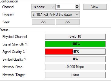

It is on all channels, see attachments

Old 7-Feb-2018, 1:00 AM   #7
OK, thank you for the images.
So, it isn't just channel 40.
There must be something wrong with your equipment or you have a serious interference problem.
Your signals are strong because of the antenna and preamp gain, but something is reducing the SNR of your signals.
Since it is intermittent, it will be difficult to diagnose.
The only thing I can think of now is to substitute each and EVERY part of your system with a known good part, even if it means ending up with a completely separate test system.

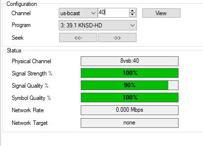

Well it looks like I may have FINALLY solved my problem. I pulled new rg6 quad shield solid copper. I also used new compression fittings and a dab of dielectric grease on all the outdoor ends. I inspected the old coax and there were a few really bad kinks in it that Im assuming were a big part of the problem.
The attached readings are with the new cables.

Thanks for the report; that's much better!

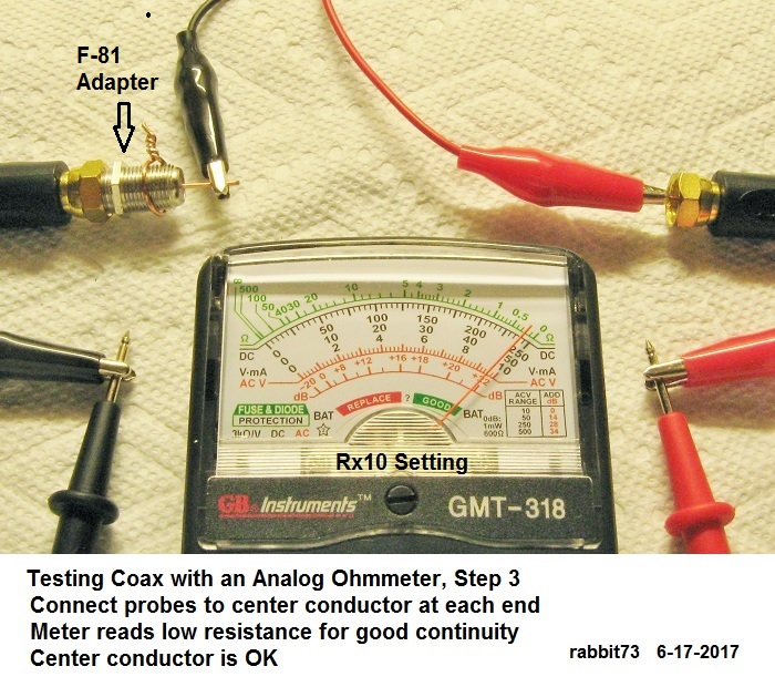

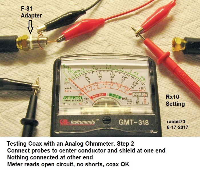

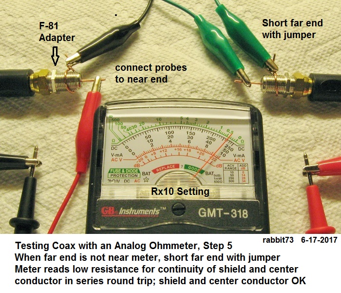

And thanks a million rabbit73 for posting the pics above. I will file this for my future reference. BTW, I think you posted previously about how to test coax cable to see if it was good for reception before you hook it up? Would you mind linking it up here? I haven't been able to find it so far. Thanks again.....
Old 13-Feb-2018, 12:05 AM   #17
OK, here it is:
