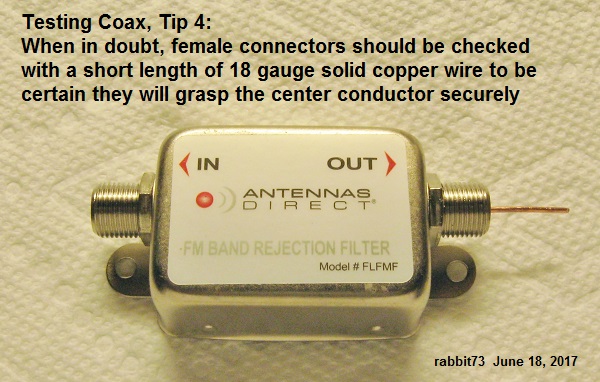

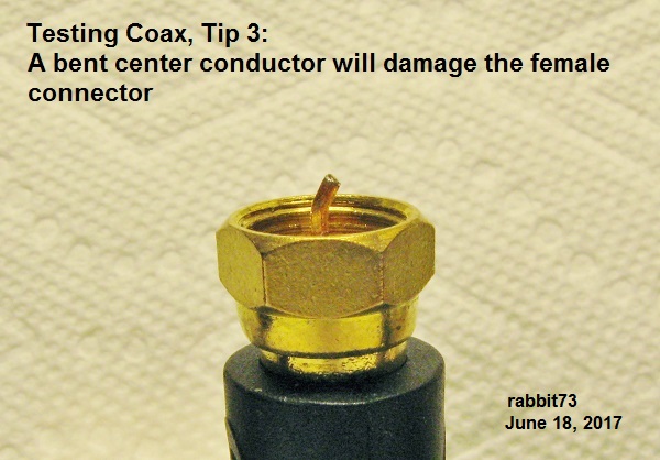

rabbit73 13-Feb-2018 1:05 AM
5 Attachment(s)
Originally Posted by OTAFAN (Post 59657)
BTW, I think you posted previously about how to test coax cable to see if it was good for reception before you hook it up? Would you mind linking it up here? I haven't been able to find it so far.
OK, here it is:
http://forum.tvfool.com/attachment.p...0&d=1518483739
http://forum.tvfool.com/attachment.p...1&d=1518483772
http://forum.tvfool.com/attachment.p...2&d=1518483798
http://forum.tvfool.com/attachment.p...3&d=1518483847
http://forum.tvfool.com/attachment.p...4&d=1518483889
