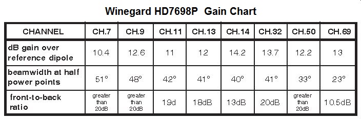

Old 24-Jan-2018, 5:53 PM   #6
Welcome to the forum, wreckbuilder
I really want WSMV
Then you must have a high gain antenna for VHF-High.
Will I be giving up much UHF reception with the Winegard 7698p compared to a dedicated UHF antenna?
No, the 7698 has good gain on VHF-High and UHF.

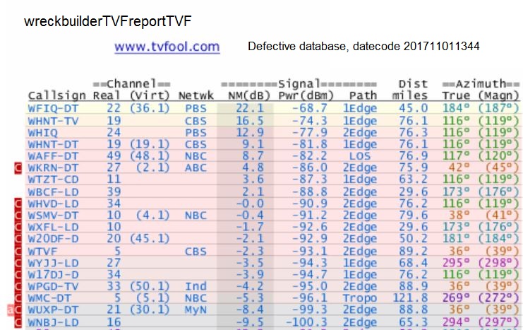

Old 24-Jan-2018, 6:28 PM   #8
WSMV has co-channel interference from WFXL, also on channel 10. WSMV must be at least 16 dB stronger than WFXL to avoid interference, but it is only 1.3 dB stronger on the report. However, WFXL is in a different direction, so the antenna pattern has a good chance of giving you the margin that you need if the antenna is aimed at WSMV.
http://www.winegard.com/kbase/uploads/HD7698P.pdf
http://www.hdtvprimer.com/ANTENNAS/W7698.html
If the antenna pattern isn't sufficient to attenuate WFXL, you can use a building or wire wesh screen to block the signal from 173 degrees.

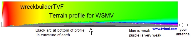

Old 24-Jan-2018, 7:13 PM   #10
The curvature of the earth blocks the WSMV signal. This is the terrain profile you will see if you click on the callsign in your signal report:

Old 24-Jan-2018, 11:07 PM   #12
Here is a terrain profile using different software. VHF signals can make it over a path like this better than UHF signals.

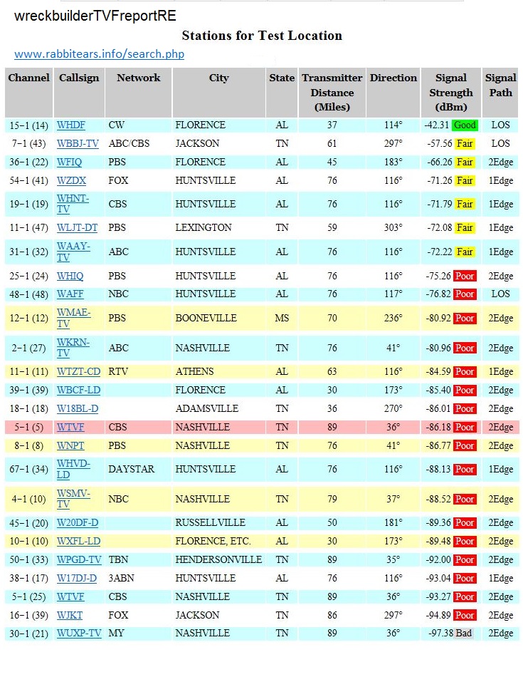

Old 25-Jan-2018, 3:20 AM   #14
Thank you for the additional details. It is getting more complicated, so I will need to ask more questions and study it further.
If you just wanted WSMV from Nashville and only UHF from Huntsville, it would be easy to combine the two antennas.
My situation is we like the Nashville market news mainly WSMV real channel 10 which we get through Dish. We want to get rid of the Dish bill.
Now I understand why WSMV is so important.
If I were there with you, I would want to buy a 30-2476 VHF antenna and a preamp to see if WSMV is even possible. It would be a $35 gamble for the antenna.

I doubt it. The FCC is cutting back UHF from 14-51 to 14-36. The channels from 38 to 51 have been auctioned to cellular companies. The listing indicates it will stay on 10.
https://rabbitears.info//market.php?...&callsign=wsmv
